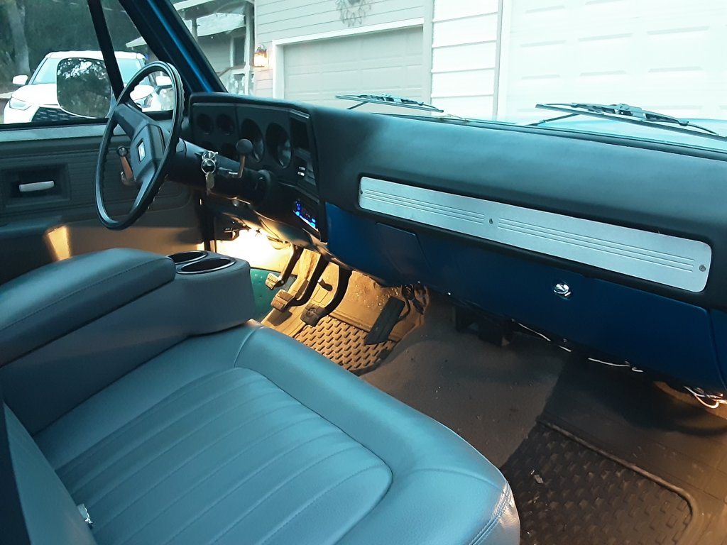

Thanks. I installed door switches and used the previous orange wire for that circuit.
