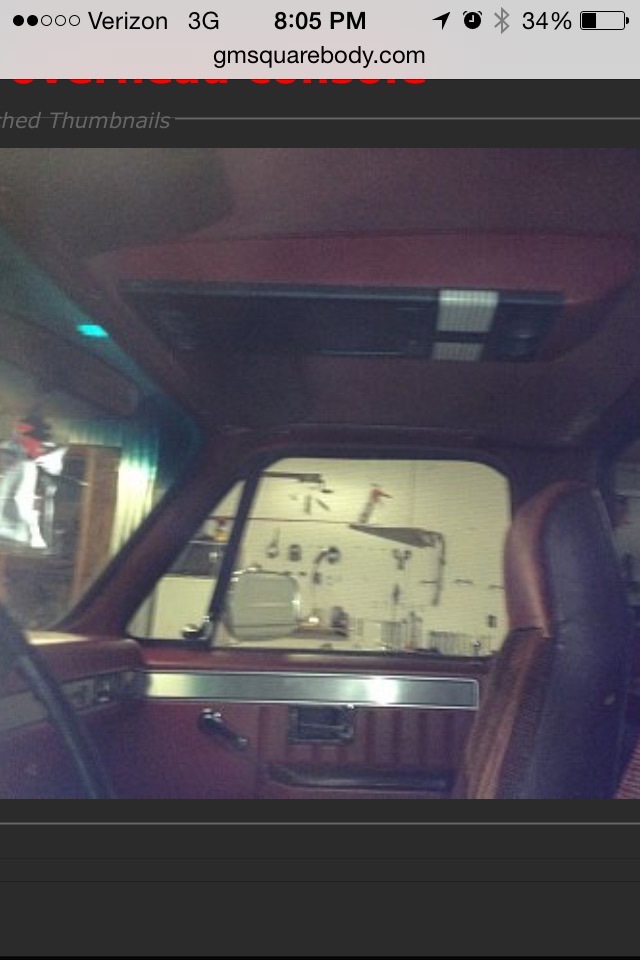

I cut and installed an overhead console from a 91 burb that I think looks good. I went ahead and swapped the bulbs out for LEDs and it is like a supernova in the cab at night.

Found the pic on an old thread. This is before I hooked up the lights. It also has the map lights you can use which are nice.

Here is the old thread where I put it in. As far as contouring it to the cab it fit tight with no gaps. I did option 1 jerry, that may have helped with having no gap also being it squished the headliner between the console and cab roof. And paw paw I didn't use the mounting bracket, I just screwed it directly to the cab roof making sure my screws were just long enough to go through the first layer of metal and not through the top of the cab. If you separate the two pieces you can screw through the top plastic piece, wire it up and then mount the bottom plastic piece and the screws are hidden. Jerry you are like a wiring guru so I know you got that but I just connected it to my existing dome light and since I believe the ground is what's broken I ran a new ground for the map lights so I can still use them when the doors shut.

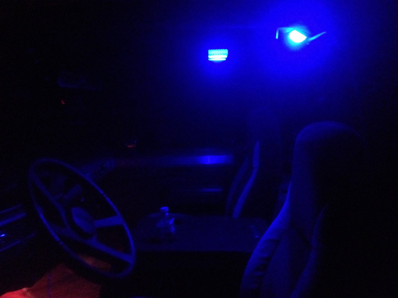

Here's the best pic I could get, has tons of glare but these suckers are bright. They are obviously blue. The map lights I purchased not realizing they were multi-color lol. They change about every 10 seconds and there are seven different colors. My kids think it's cool though, looks like a disco. The map lights aren't as bright as the dome LEDs but still work good when you just need to look at something with the door closed. The back light is the original done and the one closer to the front is the console, I think there's two dome lights in the overhead console if I remember right.
