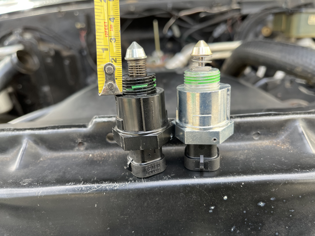

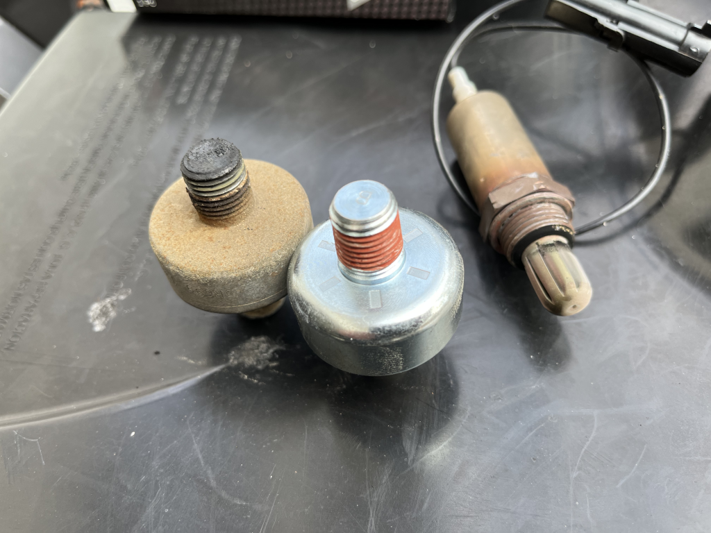

Yesterday, I ended up swapping the 02 sensor, knock sensor and the IAC. I also set base back timing at 0 degrees -
It's still acting funny. - Im going to drive it a few days see if it gets better but, the problem is - there is no constancy. —

And I know all of youz like pics so here ya go….

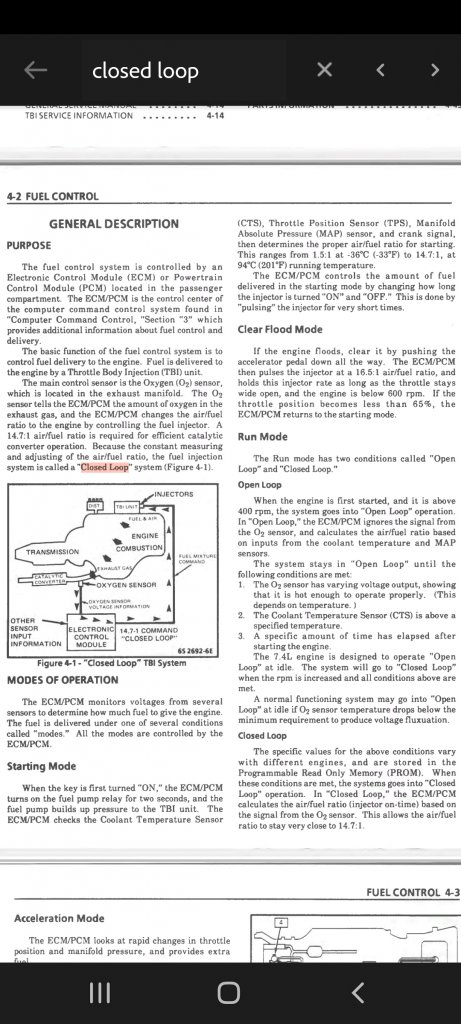

I think the engine ALWAYS starts in Open Loop, even when warmed up. if it is warmed up, it will go into Closed Loop quicker than if it is cold.
