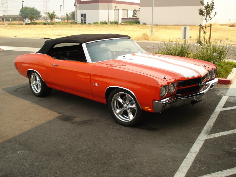

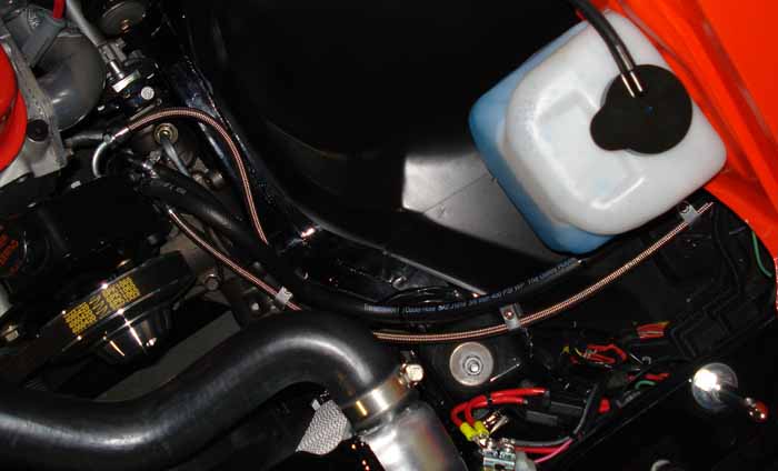

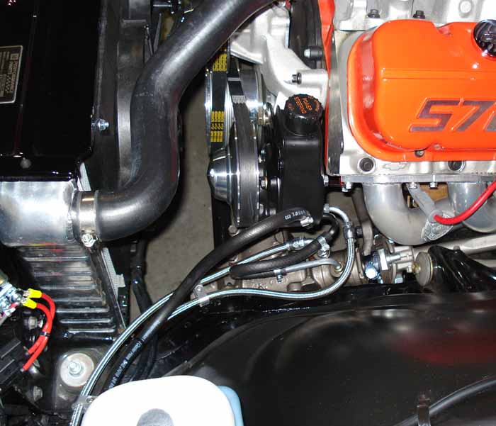

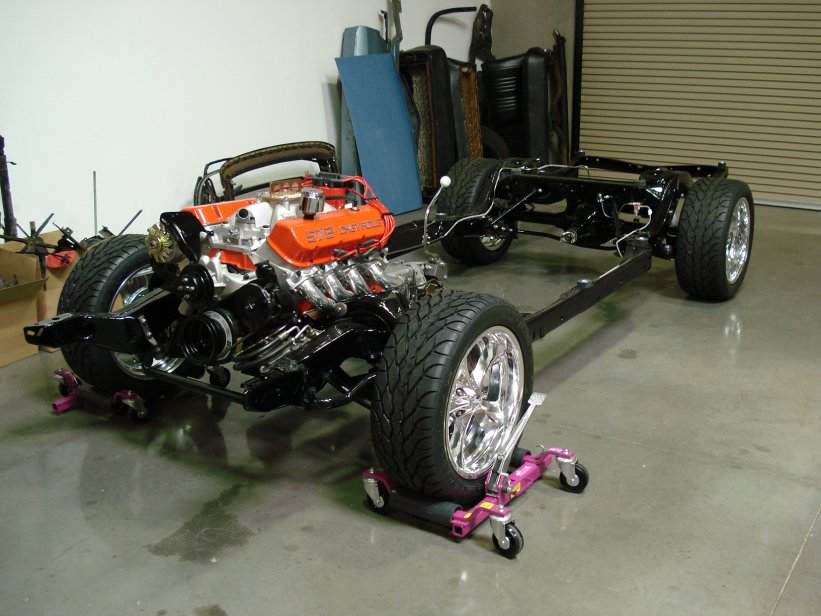

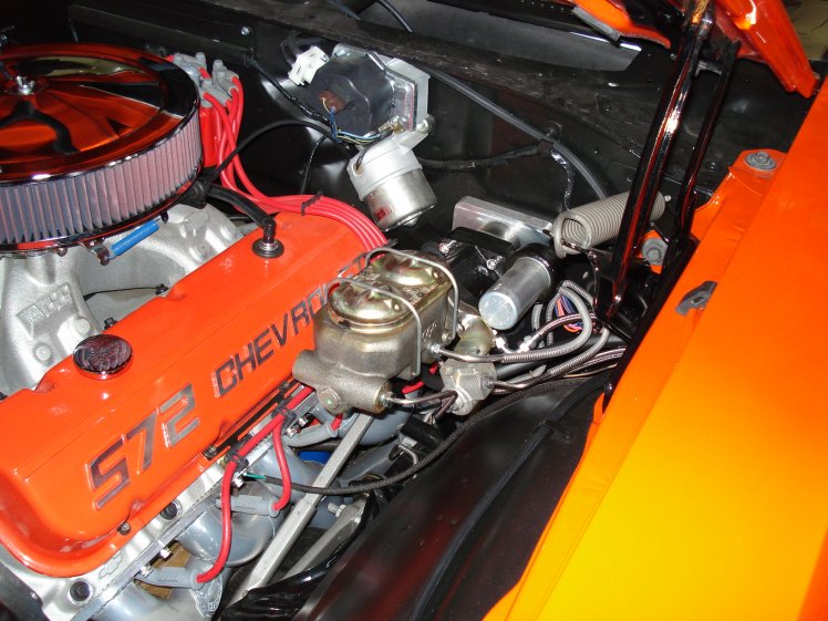

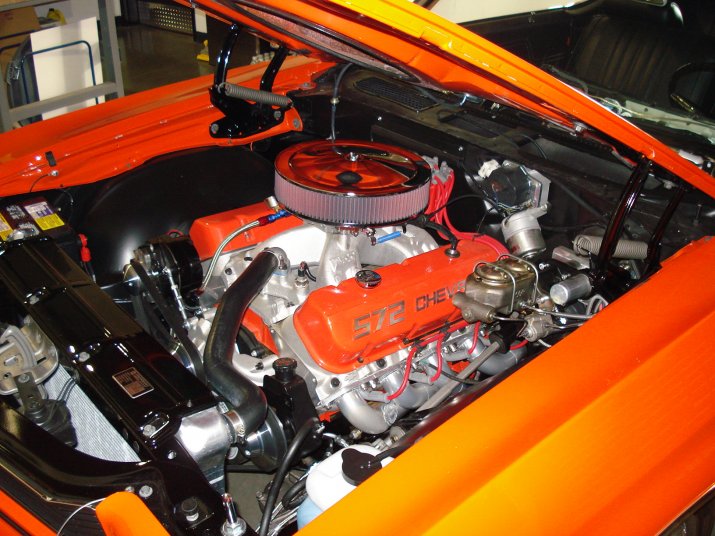

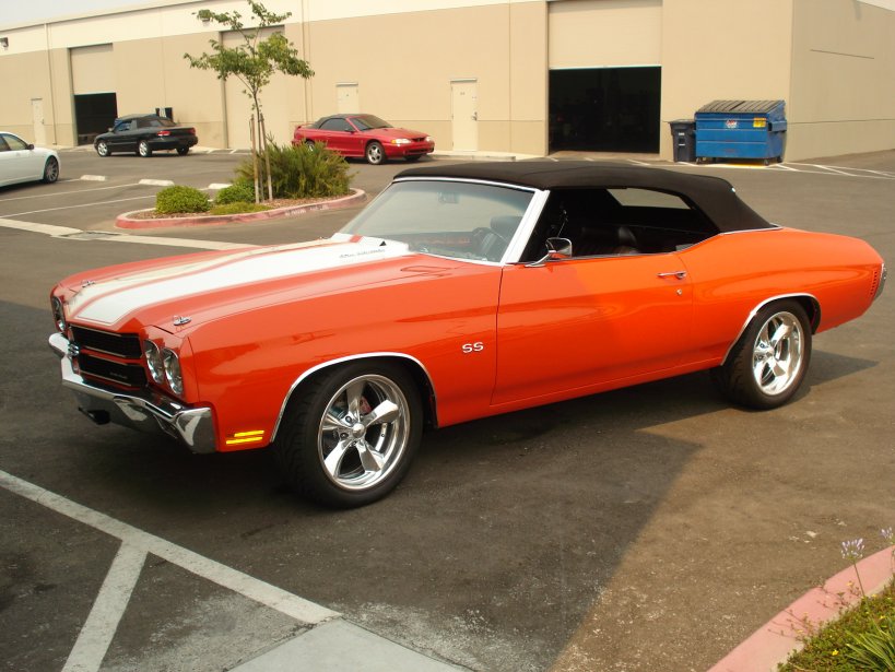

Hydro Boost is the way to go. I installed a complete system in my 70 Chevelle a few years back, got most of the parts new from the GM dealer using a Hummer H2 as a base to buy parts from. We made our own lines and tucked them into the fender so all would be hidden. Here are some pics, the 572 had a huge cam in it but this car still had brakes for days! Wish I still had that car, sold it at Mecum a few years back.
more 572 chevelle pictures please

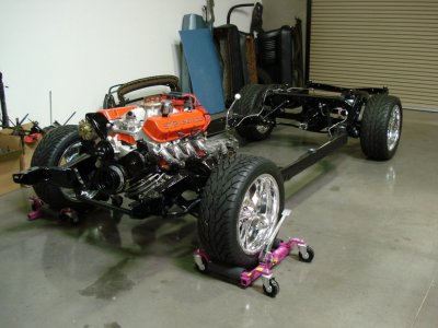

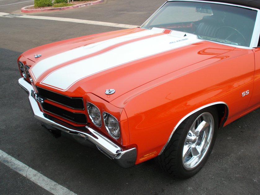

You all happy now, got your fix??

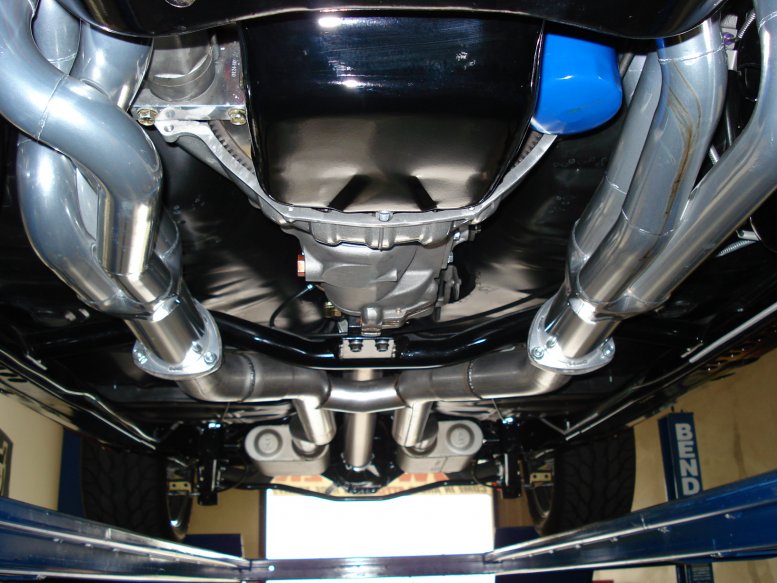

A few more..
And as for burn outs, this one will do it at 70 MPH!

That's a work of art! Were you happy with the sale price?

That's beautiful, I used to have an orange 70 SS396, mine had the white top, stripes, and interior though. Man I miss that car! Awesome looking car! You did a fantastic job on it!
