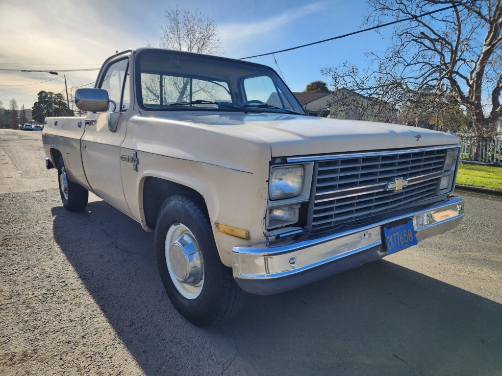

Hello all, my truck starts without issue and is at normal high idle, however it won't drop back down. It remains stuck until I put it in gear of course, but as soon as it's put in neutral/park, it quickly returns to its high spot. I don't know a lot about its history, I just bought the truck and I'm in the process of changing fluids, bleeding brakes (they go to the floor) etc. But, I'd like to get this idle issue tended to, thanks for any input, much appreciated.

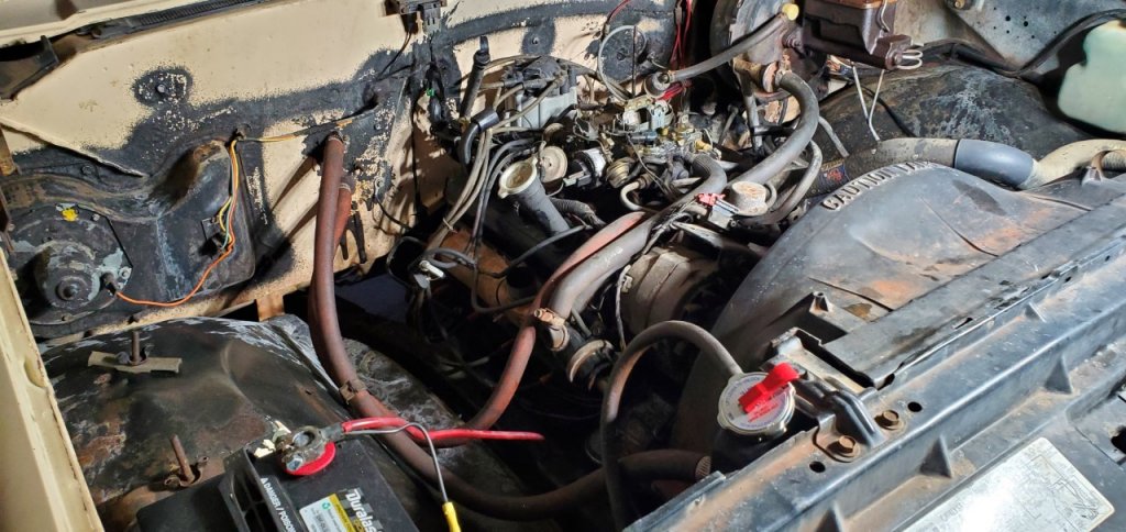

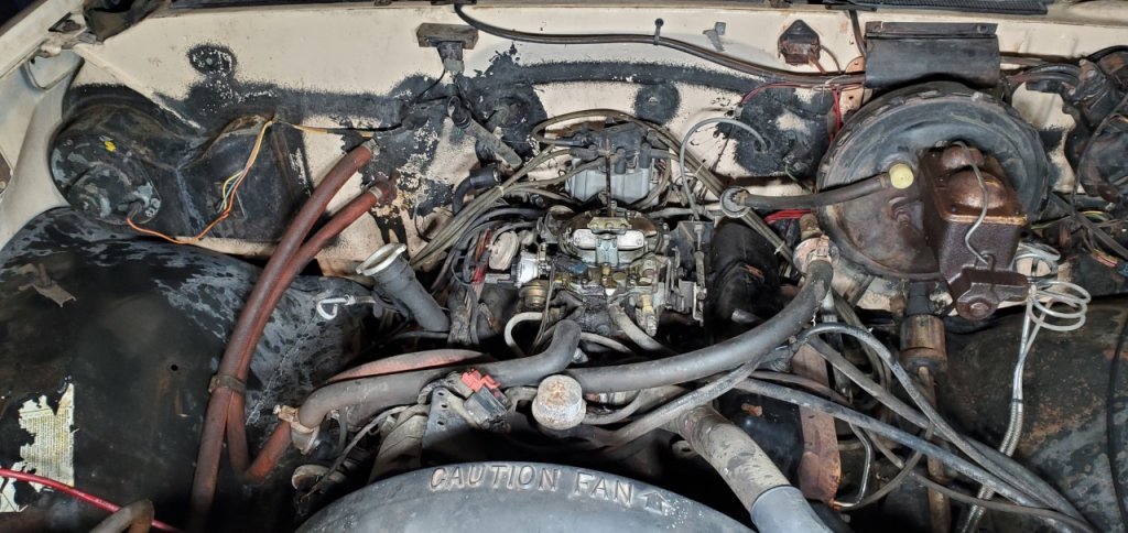

Wow, thanks for the help everyone! The exterior of the carb is pretty dirty, so I'll give that a good cleaning, also yes, I thought vacuum leaks could be an issue, I've ordered some in bulk and I'll go around and replace them all. I'll get back to this thread when I'm finished and let you all know what's up. Again, thank you for the info! I've also picked up some vacuum tube so I'll begin changing those out as well. These are more general engine bay shots I took prior to cleaning the carb, I'll get some closer tomorrow.
