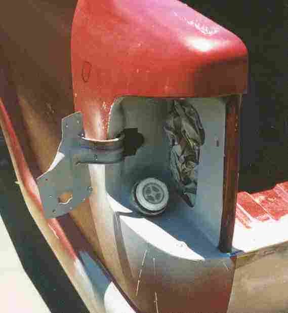

I found a picture of it done on a 81 blazer they said and it looks really clean it should be the same as on a truck bed?

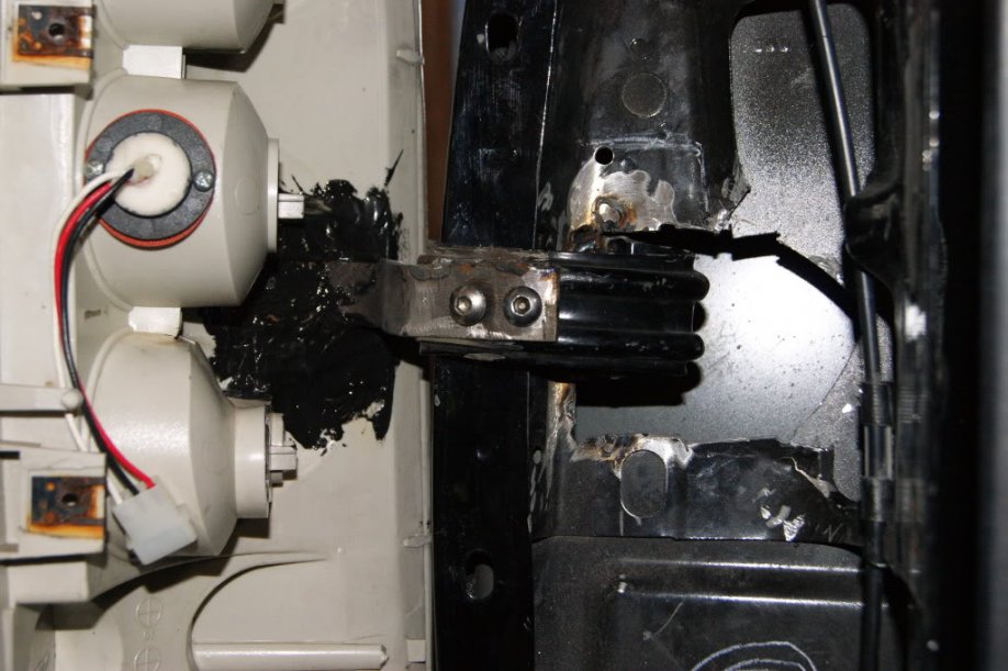

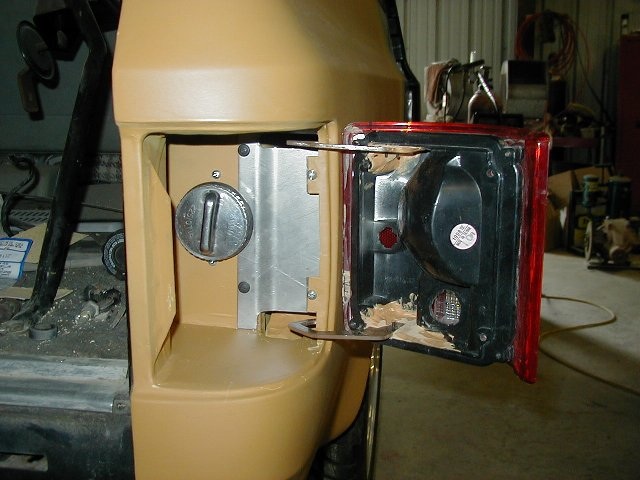

my thought was to use the hinge from a gas door. maybe one off a small car would have to look around at the junk yard to see what might work
get one that has a latch with a cable release and put the release lever inside the cab
