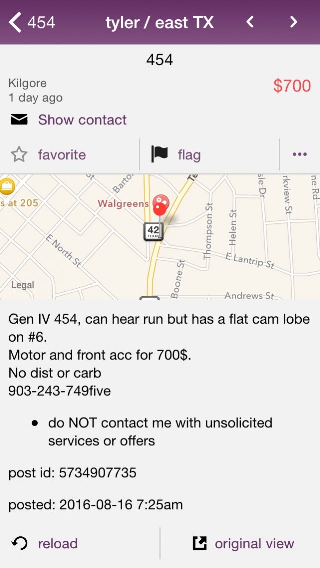

I've been looking at Craigslist for you. I don't know how far you're willing to go, but I found a '98 Chevy with a 454 that's getting parted out in Dallas, and I found a 454 in Kilgore that was more attention grabbing. If you were willing to get that one, you could sell the lesser set of heads, the intake, valve covers, etc. and get most or all of your money back. Maybe not even that particular one, but that's the way to come out cheaply on this. You could also venture into building it and/or installing it yourself if you have the time. Big money saver right there.
