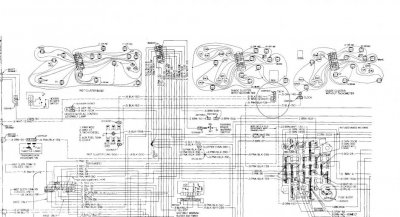

Any tach needs 3 connections. A hot wire, an impulsed signal from the distributor and a ground.
These tachs (like yours) are not part of the printed board they have a separate plug type connection - like the OEM clock.
The connector should be in an "L" shape.
The top of the long side of the L is the ground stab- run a lead to the common ground buss under the dash.
The connection under the ground stab is for a 12VDC supply - use any of the add-on sockets in the "I" row of the fuse block.
The last tab takes a signal from the distributor. Notice that like the other two tach leads in the dwg above, the white wire (121) is shown as a dotted line. That means it does not exist in your truck - unless it came with a tach. You will have to run a wire.
Next to the pink wire connected to your distributor (that is switched power to the coil primary) is a white wire. That sends an engine speed signal over to your ECM. If you are installing add-on/aftermarket tach, you will need to splice a lead into that white wire and fish it through the firewall and up to the tach.
You can make the splice at either the distributor connector or at the computer. If you aren't using your ECM just **** it off at the box, pull it back out of the sheathing and extend it.
