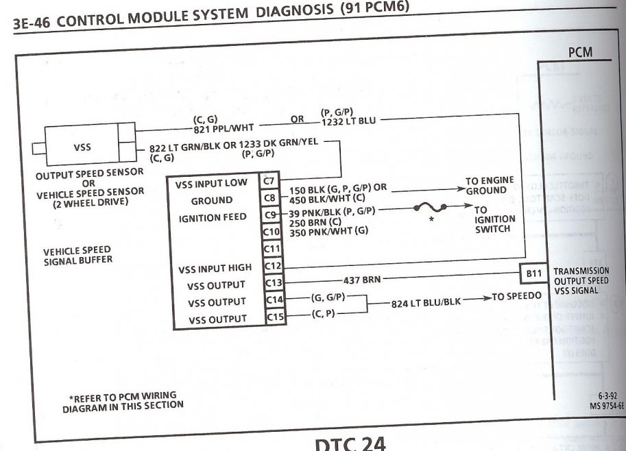

Well, you've got the VSS in the tranny and you've got the electronic speedometer. The way that this is converted from signals to readout is by the DRAC module, which I wouldn't imagine came around until 1988. Here's a picture.

V1500 Jimmy
Whoops. Here you go. It's just a matter of wiring up the module in between the speedo and the VSS and then teeing it into the wire for what the ECM wants to see concerning vehicle speed. They're all over eBay. If I'm incorrect or missing something, someone please let me know.

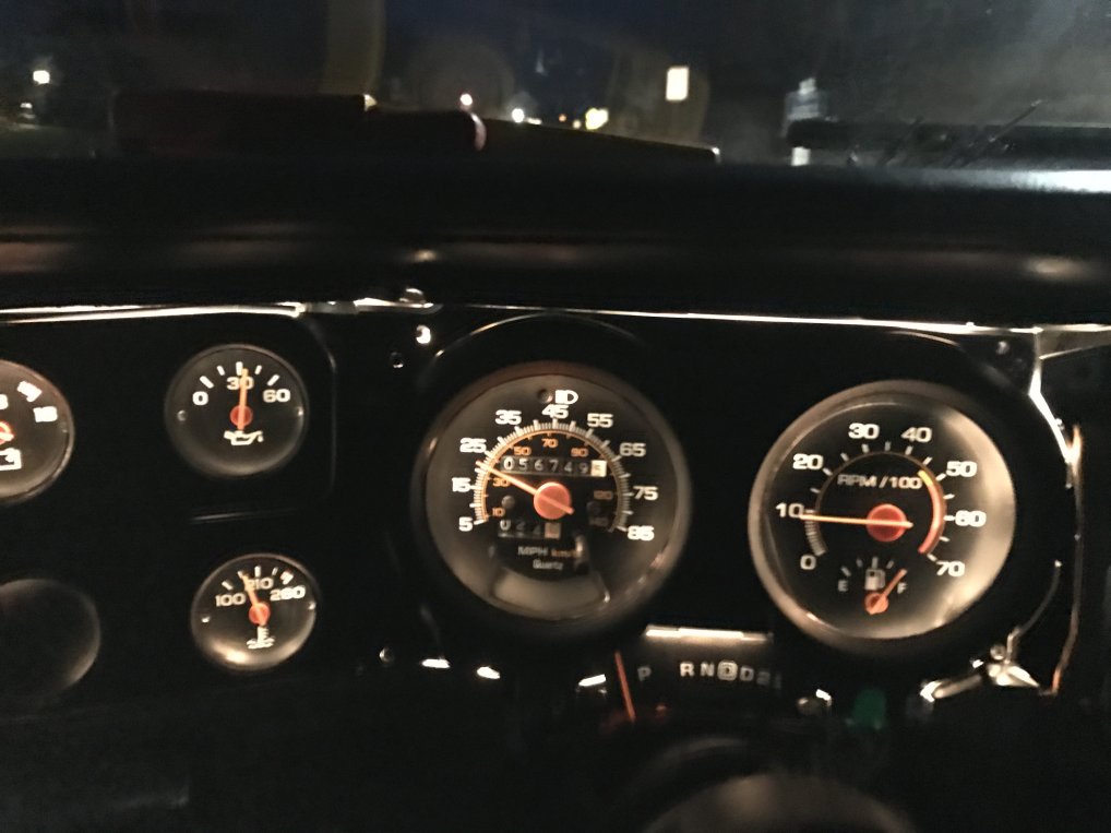

Thanks for the help fellas!!
Scored a 91 K5 cluster in great shape and the trip reset even works!!
Because my wife kicks ass lol, she bought me a GMSPORTS 7000rpm tach fuel gauge combo!
Will be nice to have a full array of gauges to monitor vitals.
Merry Christmas yall!!!

success!!!

74 Shortbed
Aug 12, 2013
6,306
1,411
Came out good..
