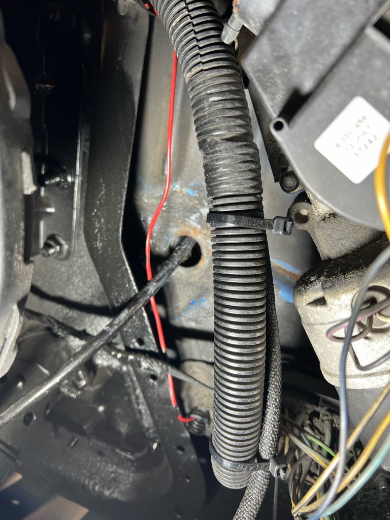

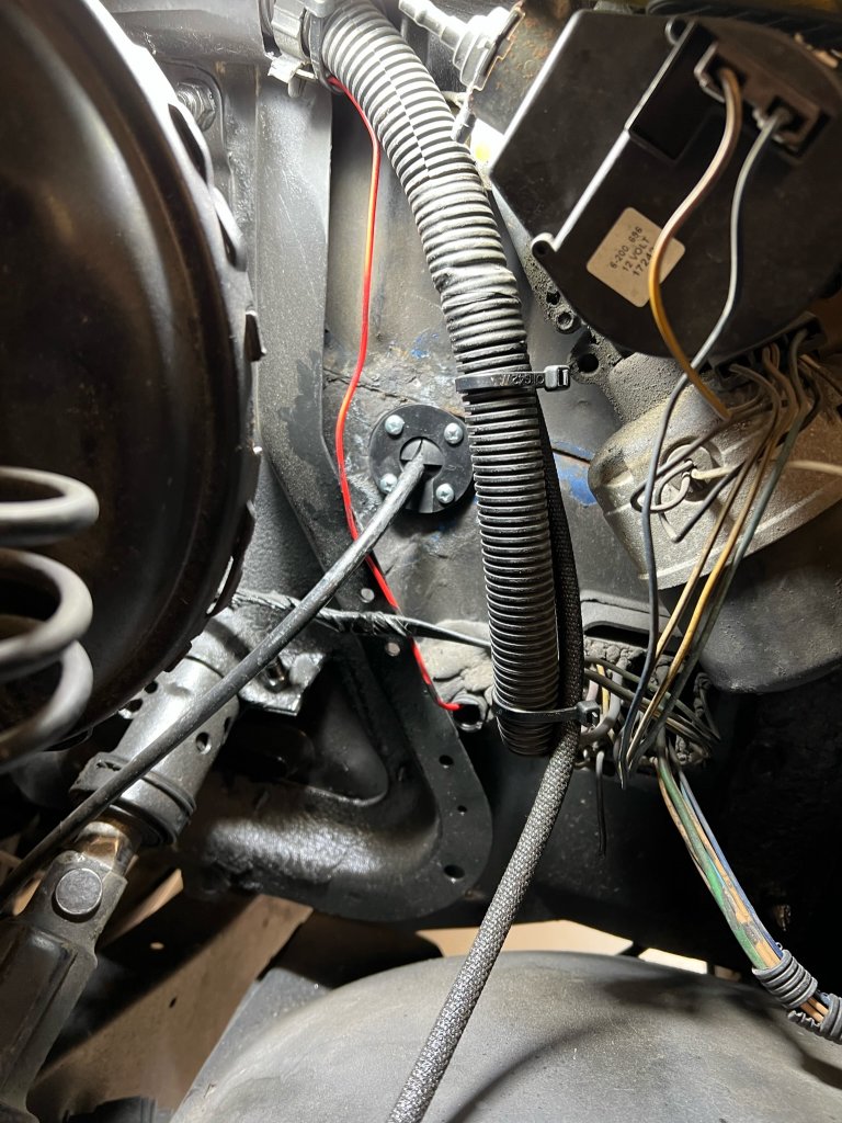

We had a problem as well so we just fabricated one.. less stress and removable.
Randy and E
