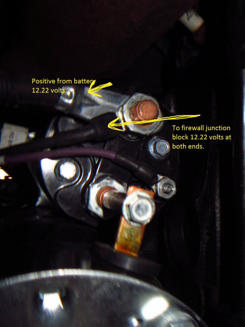

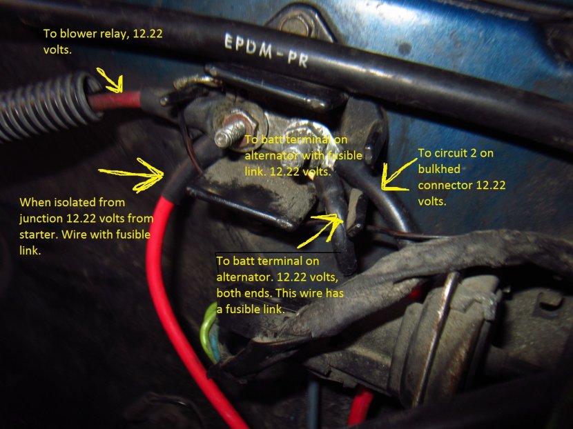

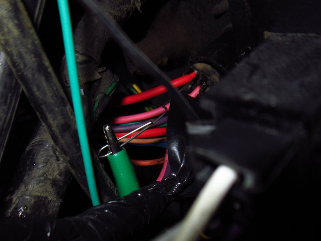

Hey guys, sorry I haven't been on in a long long time, had a lot of life happen!

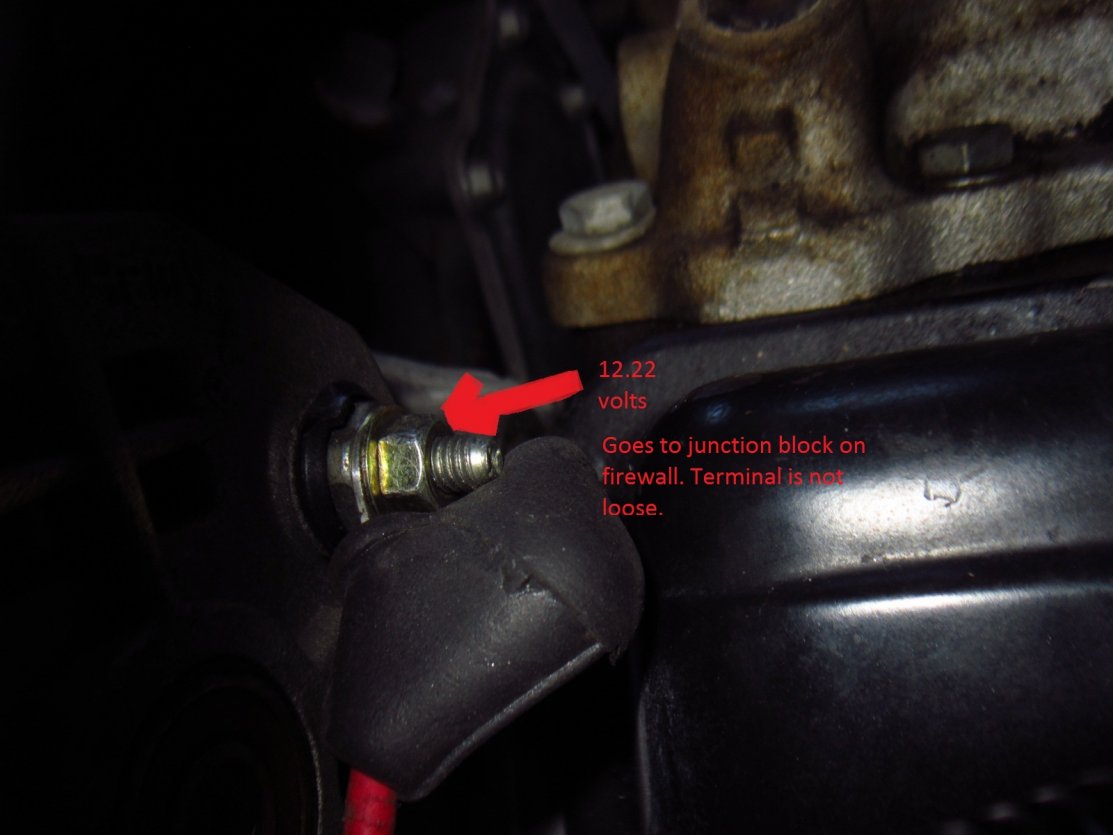

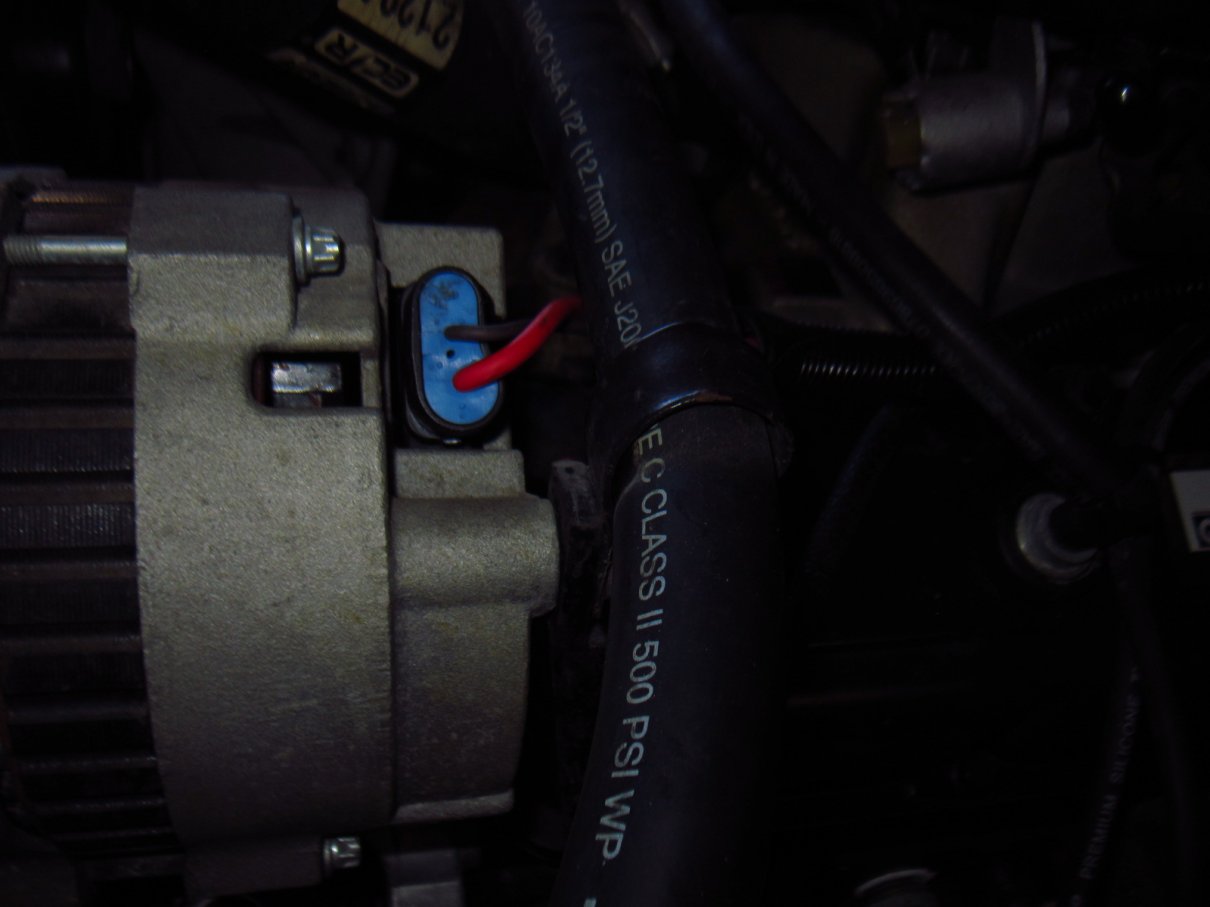

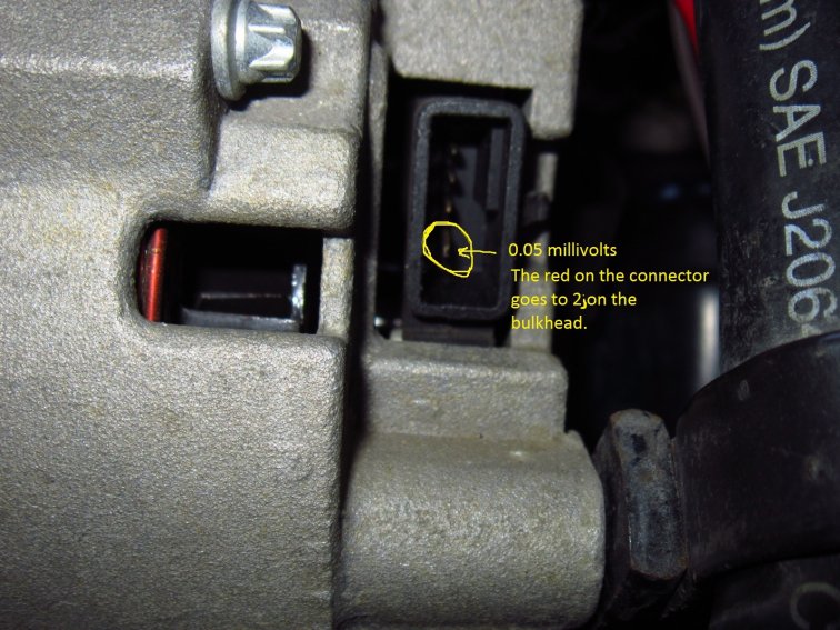

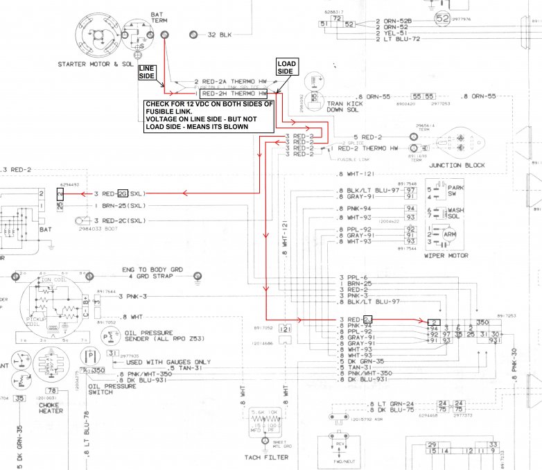

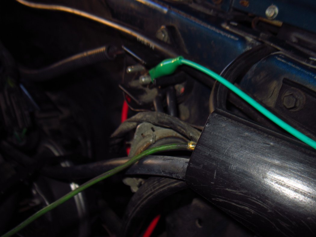

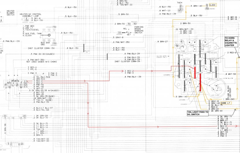

Anyway, I decided to tackle the engine harness on my 81 Silverado as the old one is all hacked up with butt splices, and lack of fusible link at the starter. I ordered one that is set up for the serpentine conversion. One at a time as I disconnected an old connection, then hooked up the new connection working from the wiper motor/washer pump, across the engine, and down to the starter. There is a tan wire headed underneath the cab I transferred from the old harness to the new harness, with the correct connector in the same slot it was in, to the left of the blue wire on the bottom row. Possibly for the fuel gauge sender? I got everything hooked up, no wires left over, and plugged the bulkhead into the firewall. I hooked the battery up, opened the door, noticed no clock ticking, and interior lights did not come on. I thought it was completely dead, and just for the heck of it, turned the key, she fired right up, and all the gauges work(except clock). Choke light stays on now too, until I short the oil pressure switch connector. It was previously hooked to a green wire I haven't had a chance to trace out yet. Oil pressure switch is MIA, Pressure switch connector was dangling, still is, but before the harness swap the choke light would operate normally, it would come on when I turned the key, and go off when the engine started. Next I check headlights, dash lights and marker lights, no go either. I do however have brake lights, and turn signals. All lights worked as they should before the harness swap. HVAC, radio(except backlight), power locks, and windows are fully functional as well. I stared at wiring diagrams until I went cross-eyed. It has to be something simple, any help sure would be appreciated!
