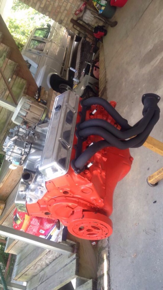

My brother bought a 1971 four bolt main 350 short block off Craigslist a few months back for $450. It came with the main accessories an engine needs to be viable also, and we were able to give the bottom end of the motor a good inspection. It has a moderate cam in it, too, but I've since forgotten the specs. We got a nice set of late sixties - early seventies camel hump heads for 300. They had been machined to the specs my brother wanted. The long block plus intake, starter, HEI distributor, fuel pump, valve covers, oil dipstick and tube, Quadrajet, and all the bolts (that came with the short block) were there for $750, and I built the thing so that was free. He's put money into other trinkets that you wouldn't need, but the moral of the story is he's got a four hundred horsepower engine give or take with the nice heads, moderate cam, Edelbrock performer intake, performance headers, and zero emissions setup for $750.

Here she is. He's supposed to finally start the sum bitch tomorrow. We'll see how that goes. Everything you see there minus the paint, plugs, and headers was $750.
