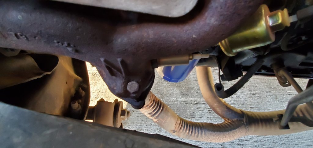

Let's not overthink the tbi system of these trucks. They are primitive compared to new cars with pre and post cat multi-wire o2s. It's just one o2 on the left side just above the y-pipe.
