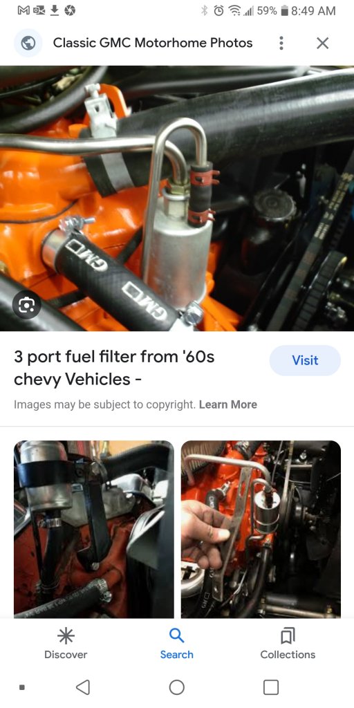

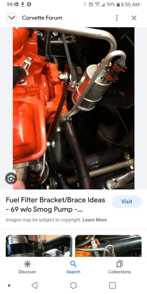

A little info for you, before the 3 line pumps chevrolet used a 2 line pump with a return style filter gf432 mounted on the water pump. So if a 2 line gets you the clearance you need plumb it like a 1969 corvette, nova, chevelle big block car. Ill look for a pic
