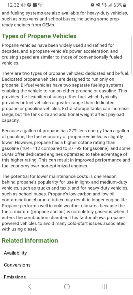

Check btu gas vs propane to get your gas mpg equivalent. I'll find it. K took a screenshot for you the discrepancy power wise is 27% Now take into account maybe a not professional job or needing some tinkering we change that 27% to say maybe 40%. 4x1.40 = 5.6. Yea still pretty low but a 305 with a big cam and I'm assuming an open plenum manifold is not going to get good gas milage. Make sure your vacuum advance is hooked up and working,make sure the centrifical advance is working,and learn how to set timing that your vehicle needs. It's a 305,with a cam,a different carb,a manifold and different fuel. You are going to have to figure out what the engine needs for timing,not what a stock 305 times at. Also if you read that screenshot,notice propane has a higher octane rating,meaning you could run more compression to make more power . A big cam lowers your dynamic compression.
