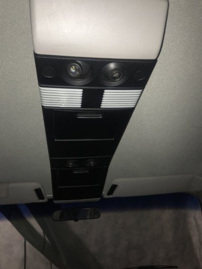

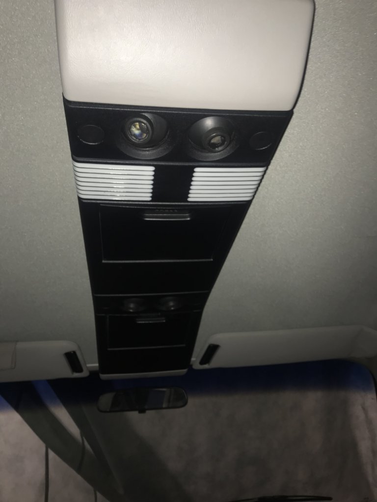

Anyone know how to access and change all the bulbs in the overhead console?
Thanks

Should be 4 black 10mm bolts that hold the plastic shell onto the metal frame, you should see them inside the sunglasses holder areas. Take those bolts off and then while supporting the console slide it forward, it should drop down and be free from the roof, disconnect the wiring harness, a single 3 pin plug. Take it out of the vehicle and start removing screws from the top. I forget how many there are, 10 maybe 12? and tart replacing blubs! If you use LED's test that you got the polarity right before you reinstall the console in the truck!
