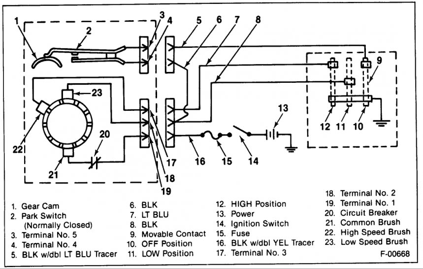

The grounding is through the bolt in the upper RH corner.
But that isn't the main motor ground.
The motor is continuoulsy supplied with power at terminal 19. The grounding leg is fed through the switch on the column and makes contact with the frame/body at the main ground bus (under the dash over by the parking brake).
Here is a simple little diagram that shows how the wiper motor is wired:

Yes thats correct. You can put it in lo or hi and its always SLOW!
Sorry, I deleted that question. Seemed a bit sarcastic.
So, your wipers are so slow.... that they are not even able to maintain normal low speed - correct?
And a new motor is installed - correct?
I know it's a pain in the ssa but you really should disco the motor from the wiper arm linkage and see if it runs at normal speed. If so, look closely at the linkage for binding problems..
If that does not get the motor speed up to normal, I think you are looking at a new wiper switch. It's not expensive, but that R & R can be a pain - it's inside the steering column.
