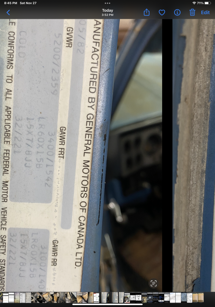

N2Corvettes
Nov 26, 2021
Fayettevillle
richard
6.2
Snapshot of door sticker. With it being a 5200 , I agree it should be JD3
