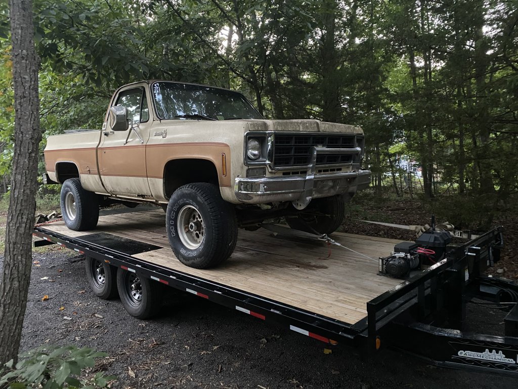

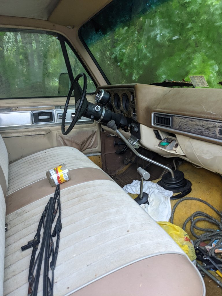

What’s up guys? I just purchased a 1978 Silverado 4x4. Is there a way to find out if the options it has are factory? It’s a Silverado with power windows and locks but has a 4spd manual trans. I did a vin breakdown but it didn’t have enough information.

That's a good looking high optioned truck it seems. Inside of the glovebox door should have a sheet(called an SPID sheet) with the list of factory options and corresponding RPO codes. Post a pic of that and people can tell you what it came with from the factory. It is sometimes also located on the inside of the fender well in the engine bay, although not usually on the earlier years.

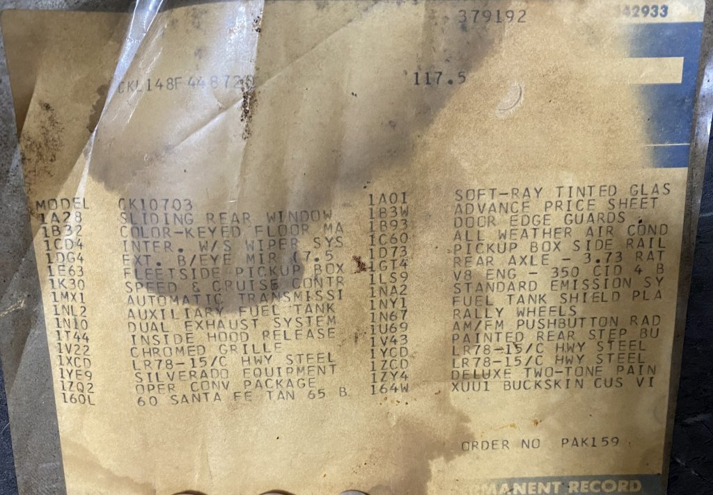

We’ll I found the paper, it explains what the options are so that’s cool.

Interesting that it says automatic transmission and doesn't mention 4 wheel drive. Is that the correct sheet or has your pickup been converted?

I honestly have no idea, I literally bought it to sell it. It had no title so I let it sit for the 2 months it took to get a title before I touched it. I don’t know if it’s a conversion or what.

The vin has a K in the second position

It has a 4speed manual (SM465), but the SPID sheet says it came with an Automatic and cruise control.... hmmm

The dash pad and gauge bezel are from an earlier year, '75 or '76 I believe. Woodgrain was used '73-'77, but the grain changed in '75 and then again for '77.
