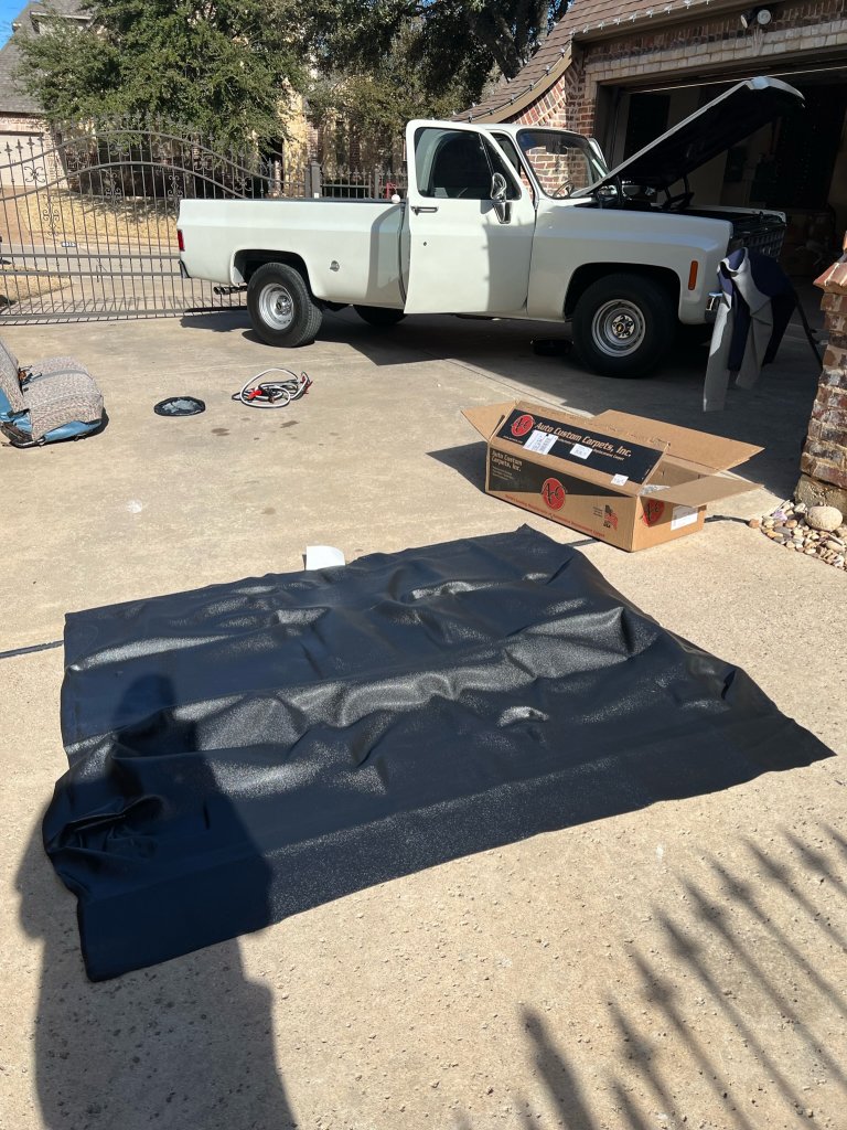

Curious if anyone can recommend a good place to find a molded "full cab" floor covering? Have found options for carpet but would prefer to go with the rubber. Have seen pics in older modification threads, but no mention of where they got them.
The mat in the truck now is in decent shape, but only covers from the front of the seat forward.

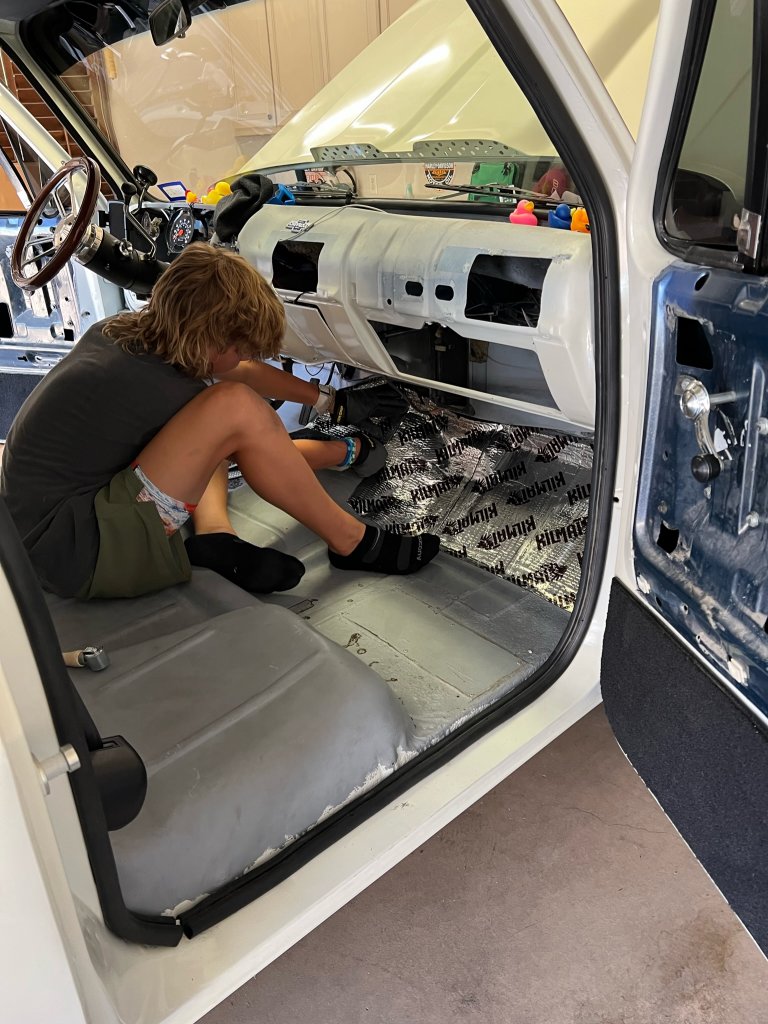

Most people use dynamat type stuff.
I used it under carpet. And if/when the truck may get used like a truck and carpet gets wet, floor pans are fully painted and the kill mat I’m confident seals well. It’s basically 1/8” of tar with foil backing, lol.
With a rubber floor I’d be even less concerned.

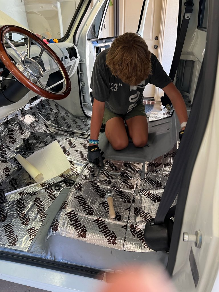

I put down POR15 on the bare floor. I then covered the paint with some Jegs brand dyno mat type stuff. Then added a jute insulation. It's working nice. I need to do the fire wall the same way. A project for another time.

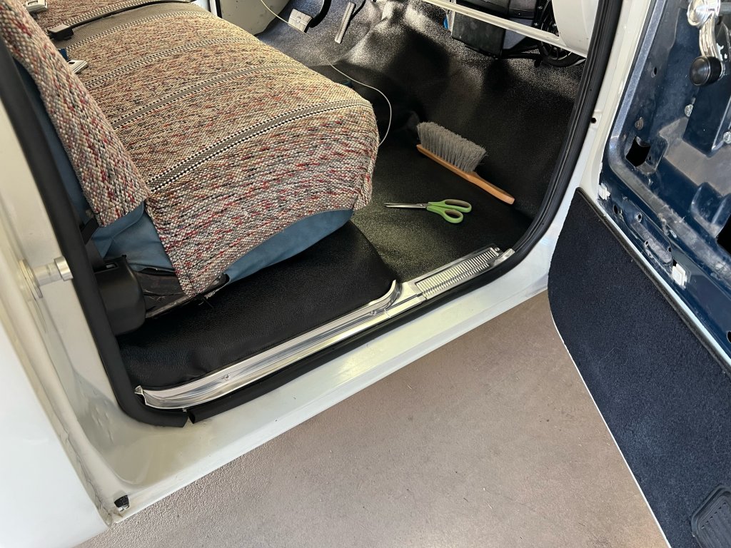

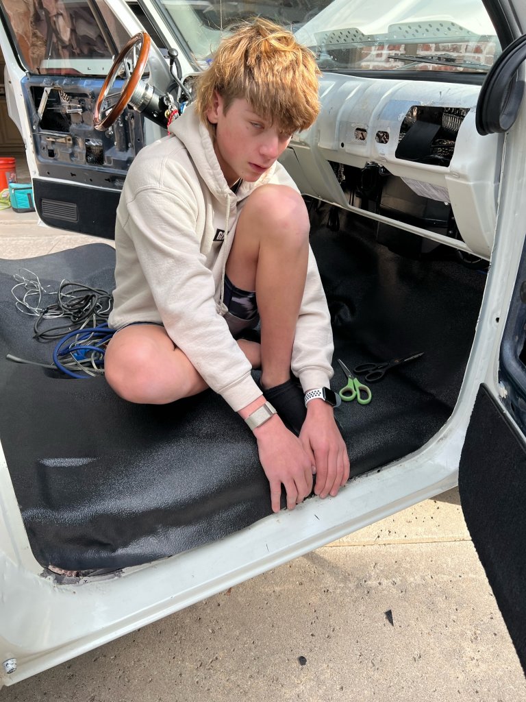

This is what Easton did.

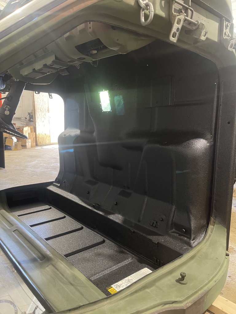

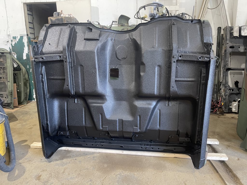

Thanks guys. I ended up ordering the heavy molded floor mat from LMC. Probably should have just gone with the regular. Will try lots of heat when I get to it but it's initial fit appears to be pretty unmanageable. May end up tossing it and looking for something else.
I did have bed liner sprayed on both the inner and outer cab floor. May just leave it like that for now and come back to it later to help with noise.
Nice outcome!
Boy I’d have a hard time justifying covering that up for a wheeler. Slap some rubber floor mats in it to catch the mud and let er eat!

Thanks. Am pretty happy with how it all turned out. That would definitely make an easy clean up. Will see how loud it is in the cab once it is rolling. Getting close to making fire with the new engine.
