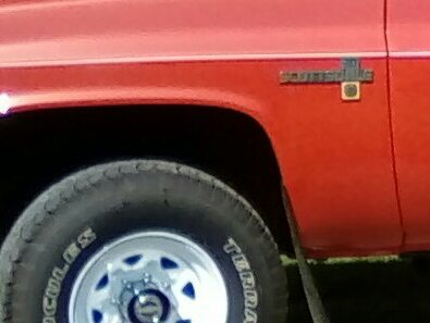

Anybody have an easy way to replace the fender badges on a square? Specifically, I’ve got a 1987 GMC Sierra Classic. The “Sierra Classic 1500” badges on the front fenders are faded terribly. Looks like I’d have to take off the fender, but I don’t really have the time or energy for that.
Looks like USA1 has a weird trick gromet to get around this problem. Anybody ever used their system?

Awesome. How do I get the old ones off without damaging the fender? I can’t reach the speed nuts with the fender still on the truck.

Take a piece of wood and set it on the emblem. Whack it with a hammer so that it breaks the studs.
Install the new emblems with barrel clips.
K
^This.
Might add covering the surrounding area with masking tape to help prevent scratches.
Barrel nuts worked great to press fit the new emblems in.
Little bit of trial and error but I was able to pop the emblem back out as well when held in w barrel nuts.
