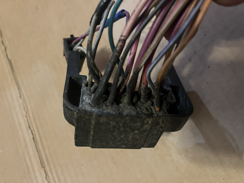

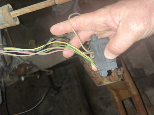

Looking for information, or diagram of some sort for wiring on 2 of the bulkhead connections for my truck.Know where most of the wires but unable to determine the rest of the wiring, schematics and the book that shows it is no longer available.
Not sure what exactly you are asking for...
The connector in the first picture should have:
Heavy wires:
positive in to the fuse block (red) for ignition
Positive in to the fuse block for lights etc.
switched ignition wire out to the starter solenoid (purple)
Hot wire out to the coil
Hot wire from alternator
others:
Alternator exciter wire
oil sender
temp sender
Gas tank sender
Several for wipers/washer
I don't have my notes with me & mine was a different year but should be similar.
