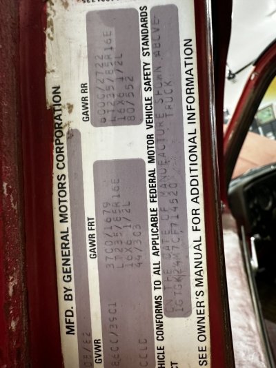

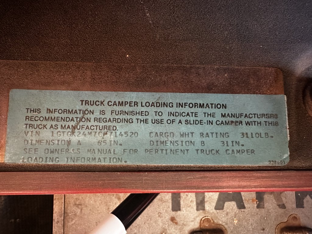

I have a 1982 GMC K25 (VIN:1GTGK24M7CF714520), however, VIN code does not seem to match the truck. i.e. it is not 4WD and it also seems to be a 1 ton, possibly due to "camper package" per photo below of sticker in glove compartment. It is a dually, and brake parts align with 1 ton, not 3/4 ton. It has a 4 spd manual (creeper gear plus 3), a 12 bolt rear axle, and comfortable cruise speed is about 55-60, so gears are pretty low. It weighs about 5,700 lbs empty with a home-made flatbed. I've hauled 2+ tons without issue. Overall seems like a 1 ton, not 3/4 ton. Engine is 350ci. And if my 1 ton interpretation is accurate, can I "bumper" tow 10,000 lbs? Input is appreciated!

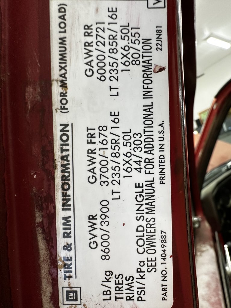

Does the vin code in the glove box match the one in the front windshied and the one on the D/S door or on the title? Start with all that. If the vin on the title doesn't match any of them you have a bigger problem. Also on the drivers door there should be a label with weight ratings. I'm not the best at figuring out what can be towed because it's not implicitly stated on the door sticker, but someone else with a better memory than mine for that stuff will come along I'm sure.

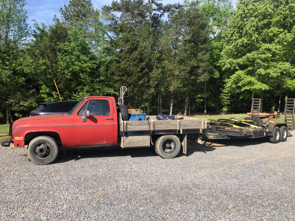

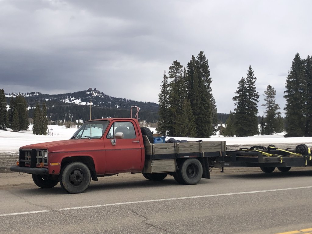

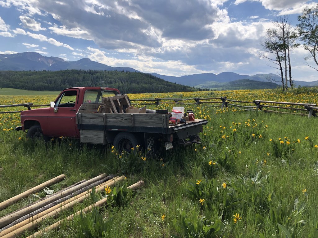

Here are a couple of pics. And I'll check axle bolt count.....12 was from memory, so maybe I'm wrong.
Towing this much would be very infrequent, and never in a hurry. It's a frame mounted hitch, not bumper. If any more detailed pics would help just let me know and I'll get them. More to come!

Nice looking truck. At least it is a dually one ton, for towing some weight. Maybe somebody changed the cab out some time in the past.

The cab is from a 8600GVW K25. Single cab, single rear wheel. Looks like someone swapped the cab onto a C30 cab and chassis frame/running gear. You can see if it is a one ton by measuring the height of the frame C-channel. I think the 3/4 ton is 5-ish inches and the 1-ton is 6-ish inches tall. I'm not sure if all cab and chassis models were 1 ton or not.

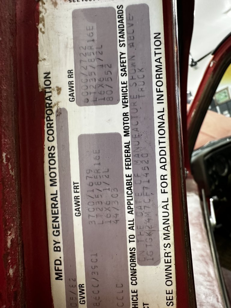

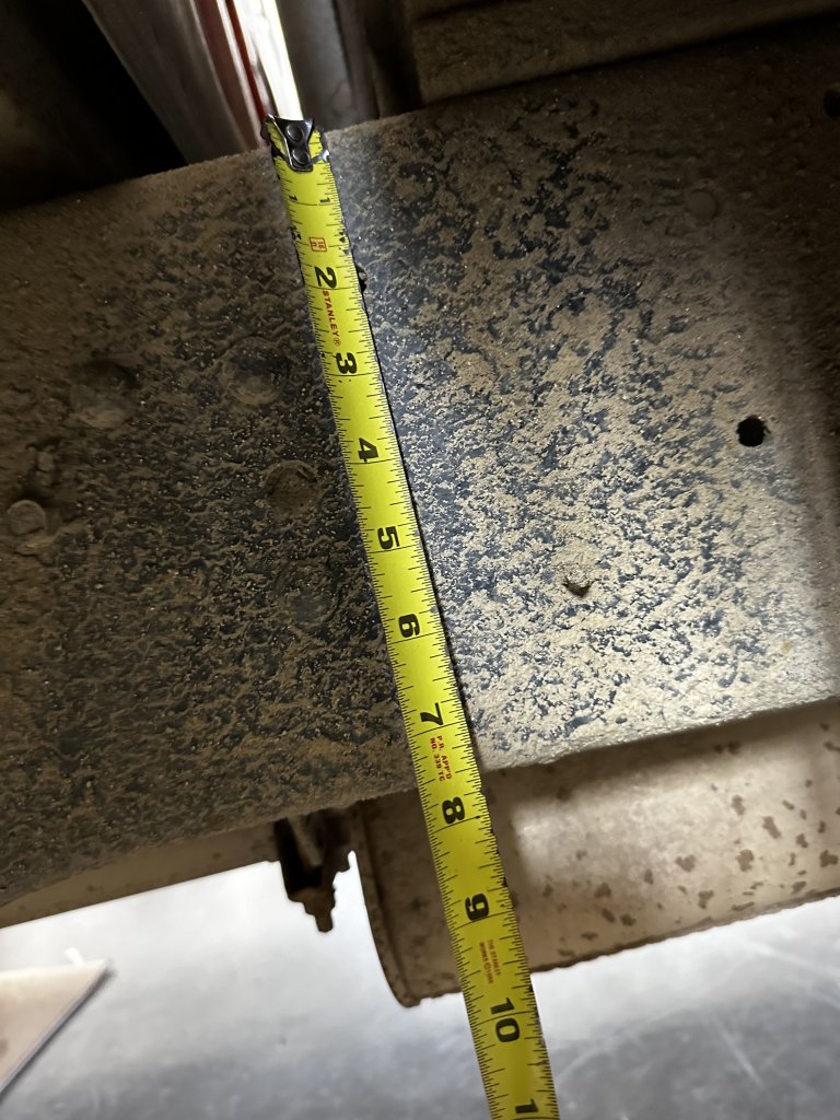

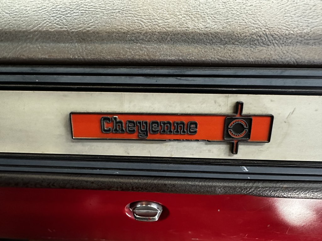

I know you've all been on the edge of your seats waiting for answers......and I am confident you were right.....someone swapped the cab at some point. VIN on cab door matches title, but there was no sticker in glove box. Rear end is 14 bolt, frame measures >7 inches, and a hint I should have paid attention to before......GMC grill, but dash has (Chevy) Cheyenne logo on it. So I'm confident it's a 1 ton chassis, and I assume from similar era, but I don't know what year for sure (any way to tell?). So I guess if I was ever stopped for being overloaded I'd have some explaining to do. Thanks for everyone's help and input!

I hope it’s ok for me to ask more on this. So, what area of the frame do you measure to find out? I ask because in front of rear axle outer to outer measurement of frame is 6.5-ish, but from above rear axle to end of frame it is 4.75-ish.
