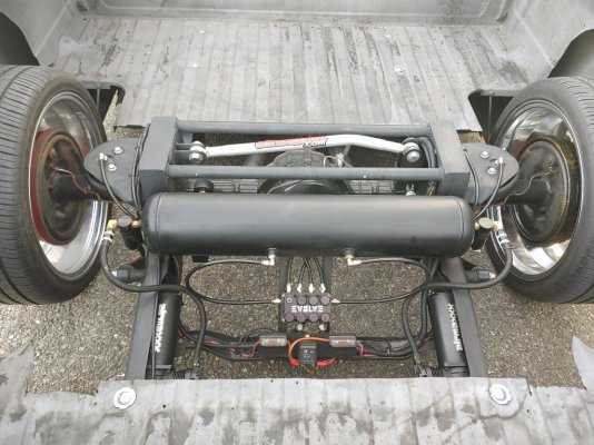

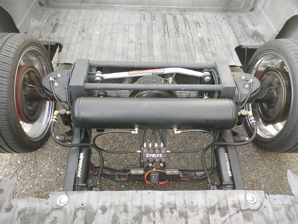

And here are some pic's of the 4-link, tank, valve body and twin compressors. ..

I have choppin block a-arms, 1" forward but not narrowed, 2.5" drop spindles an 2600 bags. Lays the front crossmember hard with no/custom inners. 245/40 tires but I need new ones an I think I'm going up to a 255/45. I have more room now with the tube arms so I'd like a little more sidewall.
The rear is a porterbuilt trailing arm conversion (discontinued). It's basically a standard type c-notch you'd do with a 6-7" rear flip. Slight trimming to the bed floor for the top if the diff. 295/45 rear tires.
Level ride height an pressure for management, 2 viair 444C with an 8 gal tank.
More pics are in my build thread.
Lowest I can drive it
Aired out
