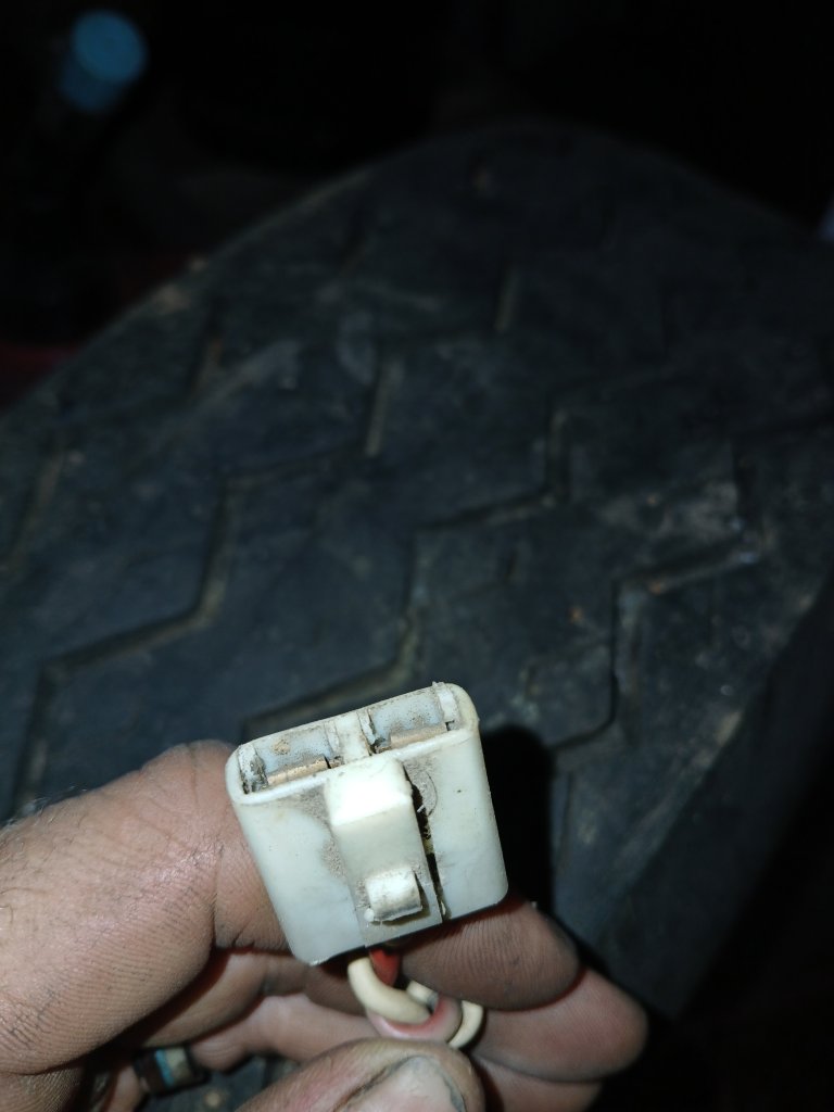

No lol. Simply unplug alternator plug while idling to see if the sound goes away or comes back. Assuming the sound is now heard all the time. Or is it literally on an off sound with a/c on and off? Plug Should look like this.

Earlier post, he wrote alternator whining? You responded yes,so he's talking about checking the connection to the alternator. If the noise is only present with the A/C on . I suspect it's the compressor or if you're lucky the compressor clutch. I really think there's not much to do I suppose you could take the belt off and turn on the A/C to verify the noise is gone. The reason I said turn on the A/C is just to make sure the load from the A/C clutch isn't messing with the alternator.If the noise is gone,start shopping for an A/C compressor andcreciever drier,before you fill the system with trash from a self destructing compressor.

Literally only when AC is on is the sound present. When no AC everything sounds normal.
