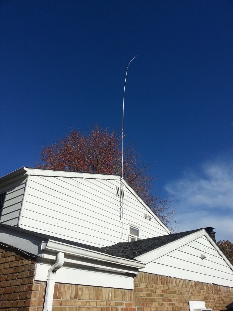

On a somewhat related subject: my wife and I like to go to flea markets, pawn shops and swap meets. One of the pawn shops I frequent had a brand new Solarcon A99 antenna, still in the box. I paid like 50 bucks for it. Anyway, I had it in the garage for several weeks, hidden behind my car on the far wall, out of sight, out of mind!
One day I had the car outside, my wife walks thru the garage and sees the box, studies it for just a split second, and realized what it was. She asks me what I planned to do with it, I told her one of these days I’m putting it up. She was not happy, talking nonsense about how it will look like crap on the house. Women!!
Fast forward about a month: she and the kids went somewhere and were going to be gone all day. Since I was unsupervised () my neighbor and decided to install it. If I remember correctly, the antenna is about 20 feet long, I used about 35 feet of antenna pole, bolted to the side of my 2 story house. The antenna was definitely pretty high up! If the weather was good, I had no trouble talking to people all over the country with a basically stock radio.
As for my wife, it was almost 3 weeks before anyone noticed the antenna. So much for looking like crap!!! I took the antenna down when I had new siding installed. I couldn’t bring myself to drill holes in brand new siding. Eventually, I’ll get a different antenna mount.
