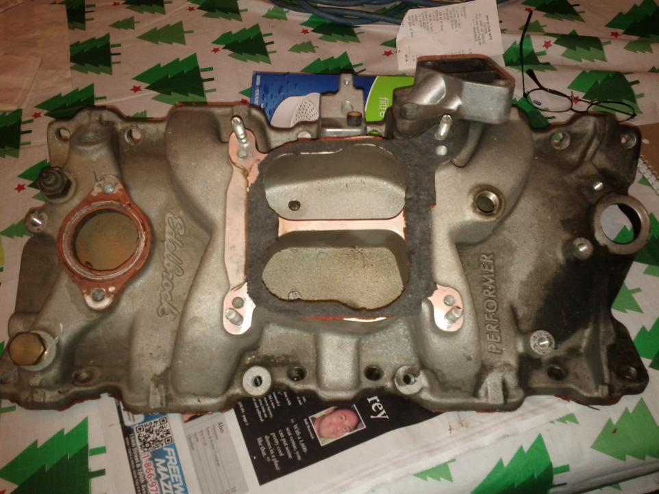

Which Edlebrock Performer do I have?

A friend gave me one a few years back.
I went to the website and no luck.
Its for a 350 SB

Are you talking about an intake or a carb Norm? As C4 suggested about the #'s on the carb, OR there is only 2 performers in the Intake, An EGR Model, and a NON EGR model. Now there is also the Performer RPM and Peformer Air Gap intakes, but they's say so on the manifolds.

If he is talking about an intake, the name should be cast into it, behind the carb. "Performer", "Performer Plus", "Performer RPM", "Torker II" etc. Then you just look the name up for the platform (350) and you'll have your model number, depending on finish, like if it's plain, polished, powder coated, etc.

Its an intake. performer. Thats all it says. It has some patent numbers on the bottom underneath but thats it.

Non-EGR should be model #2104, if it has EGR it will be a #3706.

I think I just figured out that its a Performer Air-Gap (Idle - 5500 RPM).

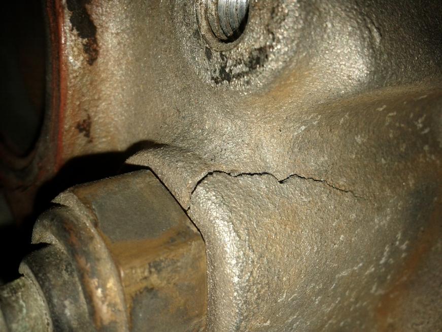

I also noticed it has a crack near the water jacket. I hope I can just weld that.

That is just a performer w EGR. Not an air gap. Air Gap, has an Air Gap at the front of the intake to draw air in like a scoop to cool the plenum.
Yes, you can have that heliarced. I'd pull the temp sensor out and let the cracks close up first, then grind a small trough in the crack and fill it. Be careful not to go to deep and damage those threads, or you'll have a thread leak forever.

But HotRod , I was just at the website loking a bit closer and the reg Performer has a much different bolt pattern and intake for the carb.
