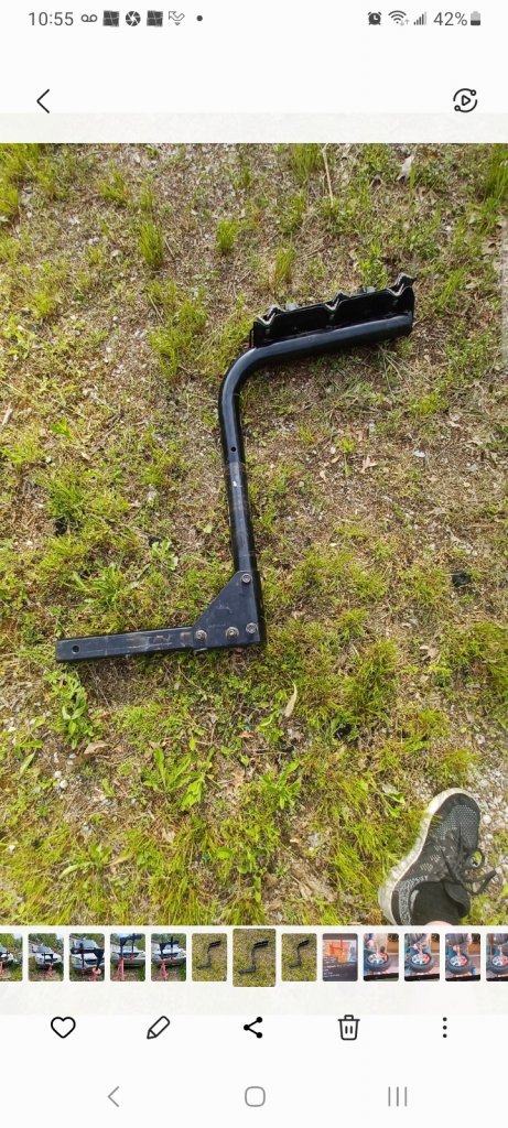

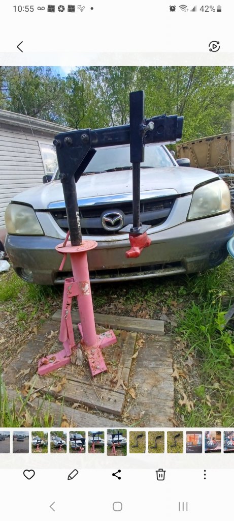

@89Suburban yes that is a harbor freight tire changer someone threw out. The arm is hitch mounted bicycle carrier,the slide is 2 pieces of square tubing welded together,the duck bill mount is a cheap dumbell center welded to a piece of plate. If I were to do it again I'd just use 2 uclamps and clamp the dumbell to the arm . It works great

Before and after shot,whole project couldn't have taken 30 minutes. FWIW I'm taking that pin out and drilling and slotting the base,like a harmonic balancer puller. That way I can use lugs to hold the wheels centered,and can do aluminum rims with no marring of the centers.

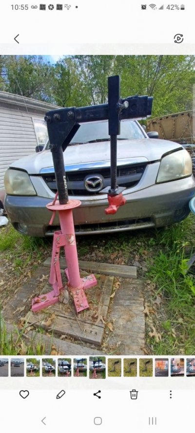

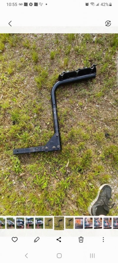

And I assume you just stick the pry bar in that hitch part and drag it around? Works good for both the beads?

Works like a champ. I've put a bar in the tube,it works,but seems like an awful lot of leverage on the down bar to the duck head. I just use a bar across the center post like normal,the other side of the bar resting on the Plate just above the duck head.

Gotchya, good stuff. The duck head on the pry bar that comes with the kit blows.
