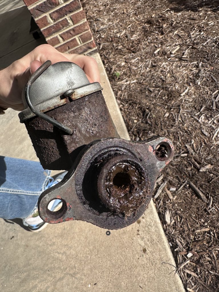

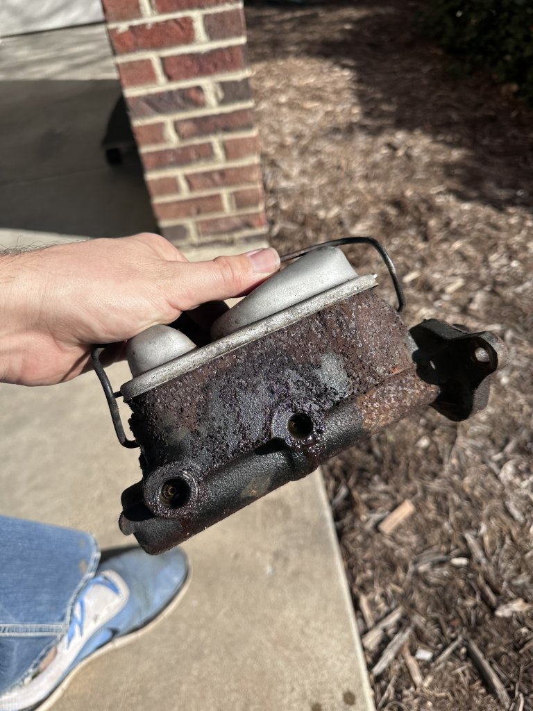

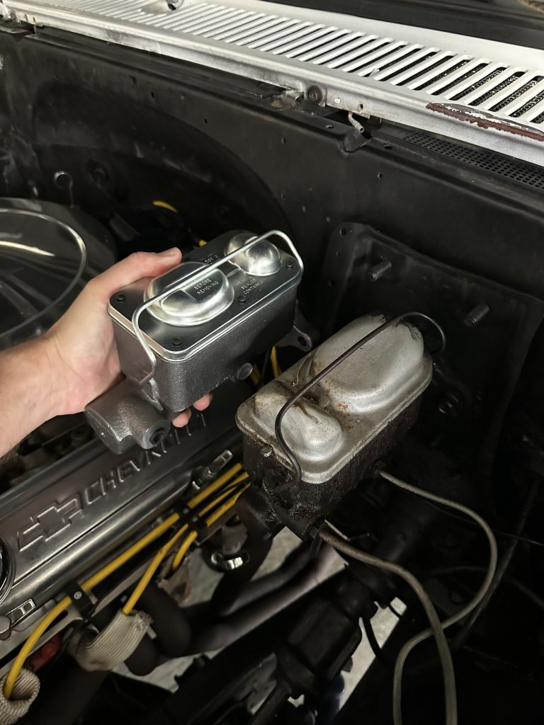

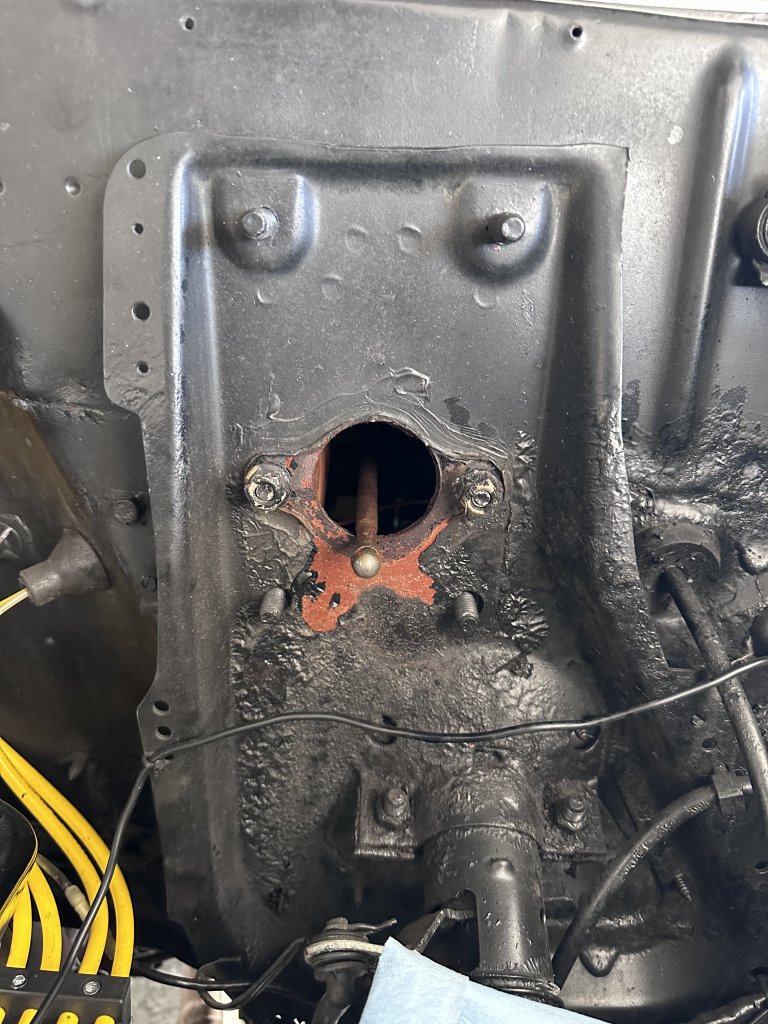

Couple photos of before and after I took the master cylinder off. Thought I could just put a new one from O’Reilly on, but flanges too think and rod is too long. Realized it had a brake booster in it from the factory and wanna restore it to factory things or better.

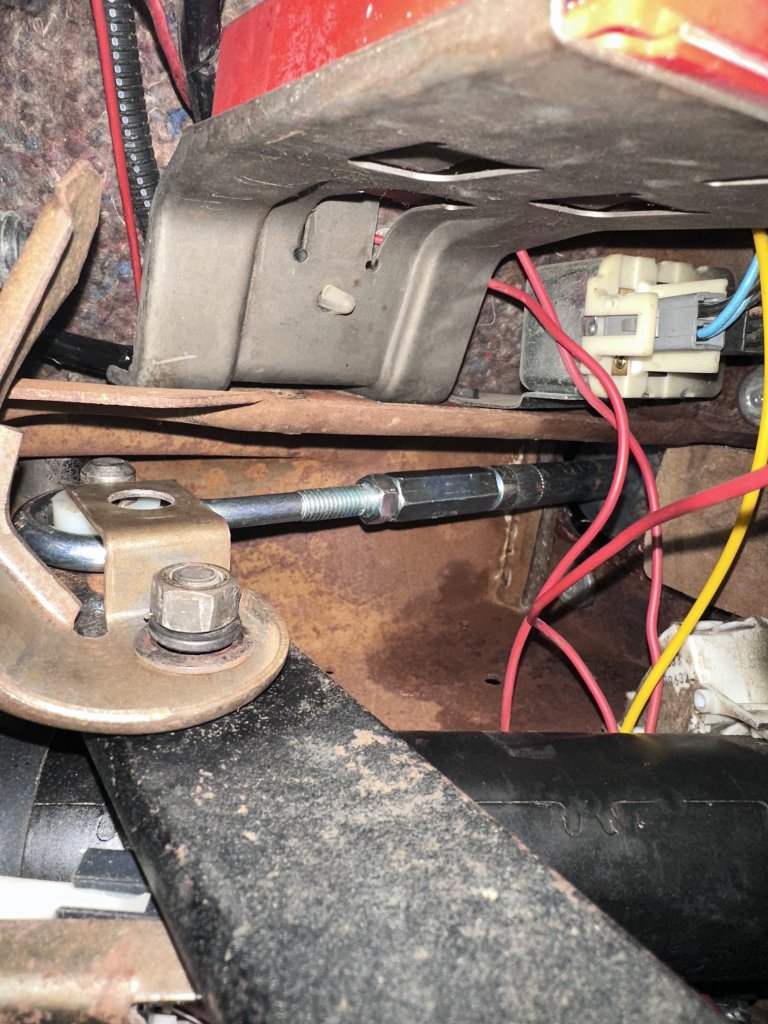

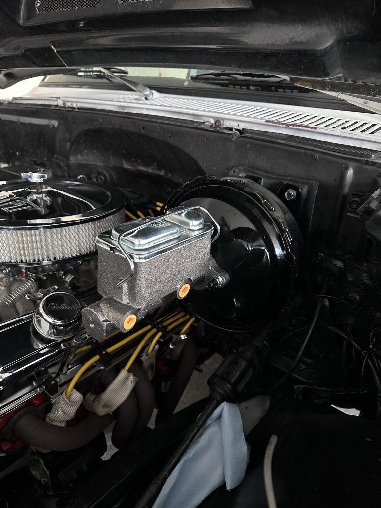

Went with the cheapest options from EBay for MC and BB. Rod coming from the booster was short, and previous truck owner had welded a different through pin on the brake bar. I engineered what I needed with an eye bolt, nylon washer, and coupler. Should work great. Gunna bleed the MC, run hard lines tomorrow if I can get these daggone tube nuts out of the proportioning valve.
Also may try to create a dust boot for the firewall to block some air and noise from coming through.
Stay tuned!

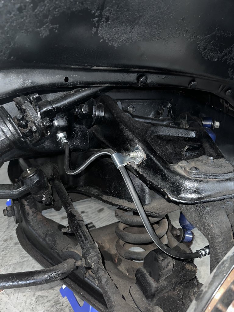

Replaces both front rubber lines and the single rear while I was at it.
