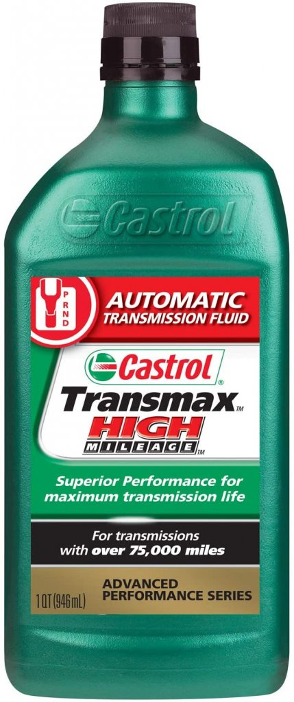

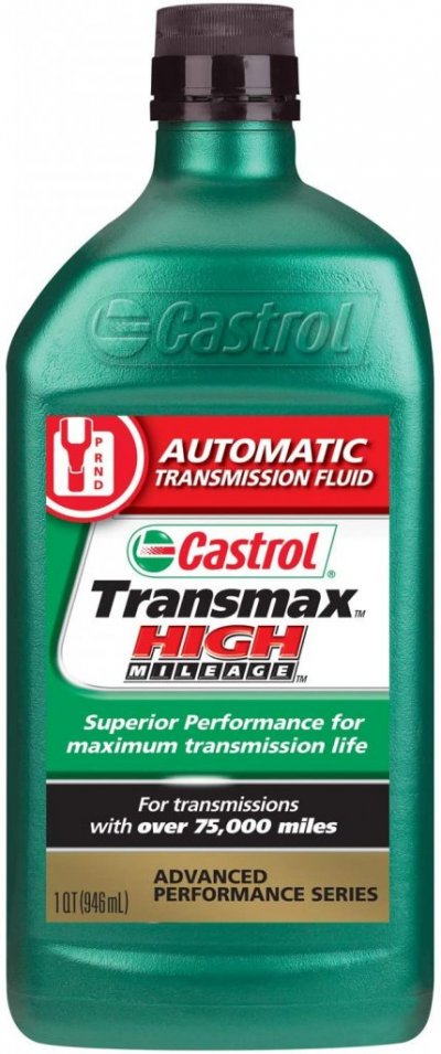

Idk if its dex or mex or both but this is what i use in all my vehicles.
