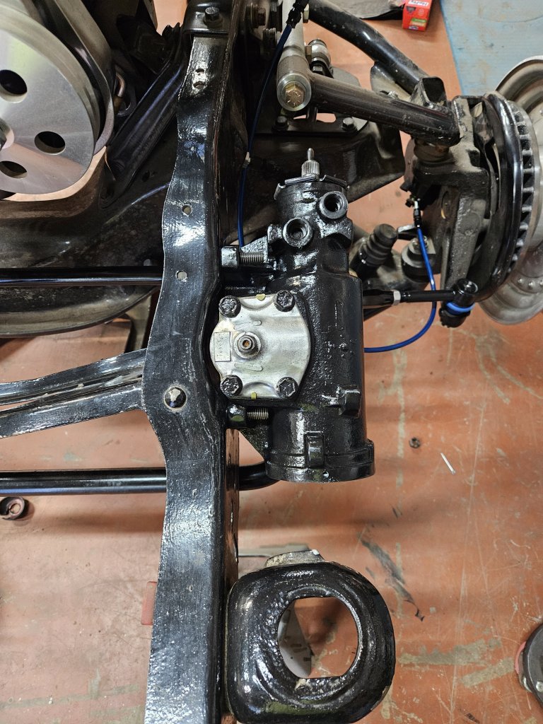

Got the steering gear back together. Getting all the ball bearings back in is a B I T C H!. Had to do it twice. The front cover lock is a big pain also. But all in all it isn't that hard. Just time consuming. On a scale of 1-10 I give it a 6. I'm very pleased with myself. I'll never buy another steering gear, I'll rebuild from now on.

I've thought about rebuilding my own too but was curious what you do if there's excessive wear in the worm or a few of the balls? Redhead an a few other places make a big deal about fixing that an say most of the wandering issues are caused by that.

There are replacements parts, that can be bought. I don't see how a solid steel worm gear can wear out with the ball bearings being the only thing riding in it. Maybe if the inside of the case would get bad grit in it. My gear box sat outside for better part of a decade, but it was fine on the inside. A good cleaning will take care any grit you might have.

I also did my own, just requires patience & concentration! After I aseembled it & put the seal & cap on, i found a bearing on the floor! Sure enough, it was short one when I disssambled it and counted them. It;s also a bit tough distinguishing between the black & shiney bearings!

I rebuilt mine a few years ago because it was leaking around the input shaft. I did a full rebuild and then did the proper adjustments per the original instructions. It was a little bit tighter and didn't leak for a few months, but then it started leaking again worse than it had before. I finally just did the redhead replacement because I didn't want to take the time to rebuild it again. It was a MASSIVE difference in feel going down the road and also in ease of turning and hasn't leaked again since. Well worth the money in my opinion.
