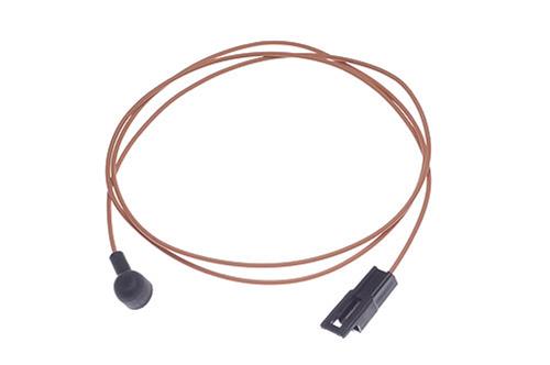

where can i find a replacement sending unit wire? mine is cut and the pop on end is missing ? anyone know who carries this?

I'd like to know this as well. Previously, I have just scavenged and replaced the connector with an old used one.

https://www.summitracing.com/parts/aww-ca97607
Ive never pulled that connector apart, but this seems correct other than wrong application with the little pass through grommet. There's a couple other options in the related section.
