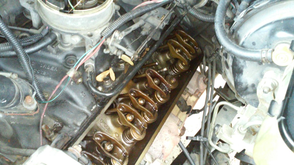

Ok so the engine in question is the 305 in my 84 C20. Mileage on the engine is unknown. Over all health of the engine is good and it's been taken care of and isn't slugged up. Compression is good and even, runs good oil pressure even when warmed up on hot days. I've got another thread or two on my spark plug fouling woes, but basically the summary is #7 suddenly oil fouled, truck has had a long history of giving a puff of blue at start up. Now I can only go a few hundred miles before I'll foul out #7, but over all oil use is nill so I feel it's all or mostly going into #7. I never see smoke while going down the road, but the truck has a cat in good health so that could possibly be masking it.
Symptoms, fouls out #7 when it starts to foul misfire will be noticed at idle, and progress to full misfire. Now another thing, if I run the engine hard like lets say I'm loaded or towing my trailer, I'm likely to go up a hill floored or near floored at relatively high RPM maybe 3K - close to 4K, you know in the power band. It's likely to mis after that, is it possible or likely for SBC to pull oil though the valve stem seal under those conditions. We have discussed at work that might be any of the valves not sealing when it gets a little extra hot, a weak spring or seat, but I have no other symptoms of that kind of issue, no backfiring or popping.
So I'm about ready to pull the trigger on a reman 350, but I hardly have the time for the install and money is always tight. I briefly thought about tossing remanded heads on the 305, but if there is any chance of lower end issues I don't wanna put the time and money into that but, I might be willing to put valve stem seals on at least #7 and see what happens.
As you guys know I'm a long time mechanic, but not an engine builder at all. So I'd like thoughts / opinions.
#1. Misfire after a long hill at high RPM and throttle, any chance this is oil sucked past valve stem seal?
#2. Replace factory o-ring type seals, use umbrella seals, or both?
#3. Do just #7, all of them on that head or both heads?
#4. Is it worth while to replace the springs on how ever many seals I do?
#5. Is it even worth while to do valve stem seals? or is it time to stop screwing around and put a 350 in it?
Open to other ideas and thoughts, but not interested in LS swap. Thanks.
