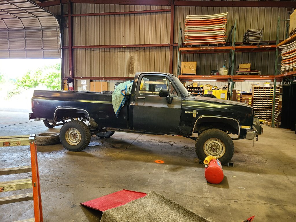

Just finished installing procomp 4in leaf springs. The truck now sits low in the front by 3 inches. All the leaf bolts are currently loose, and shocks removed, as I thought maybe something was bound up. It looks terrible. Has anyone experienced this? The springs are marked with correct part numbers but im wondering if they are marked wrong.

Body line, at center of the wheel, to floor is 46in in the front, and 49.75 in the rear.

It looks fine from here.
Add some bags of concrete, a load of sand, rock dust, logs, anything heavy and drive it around and let it settle in and report back.

3" taller would look way too nose high, just my 2 cents.

I see the problem,the wheels and tires aren't big enough. JK. I'm going to take a tape to my k brb.

My truck sits 2.75 inches taller in the rear and looks fine,it's probably so they are not aiming the lights up when they are loaded.

Agree it doesn't look bad. It may be you need to add a leaf in the front to make up for the diesel and winch?
If you're looking for level, it would look worse squatting with any load added in the back, imo.

Trucks always sit high in the rear, that looks about right. If you want it level, you need to spec some different front or rear springs

It might be that winch on the front that is weighing it down in the front. When you load up your gear/ cargo in the back you will be about right. Tough looking square, it looks ready to go to work.

Some 35's and nice set of wheels will set it off. It looks much better than these squatter boys around here.
