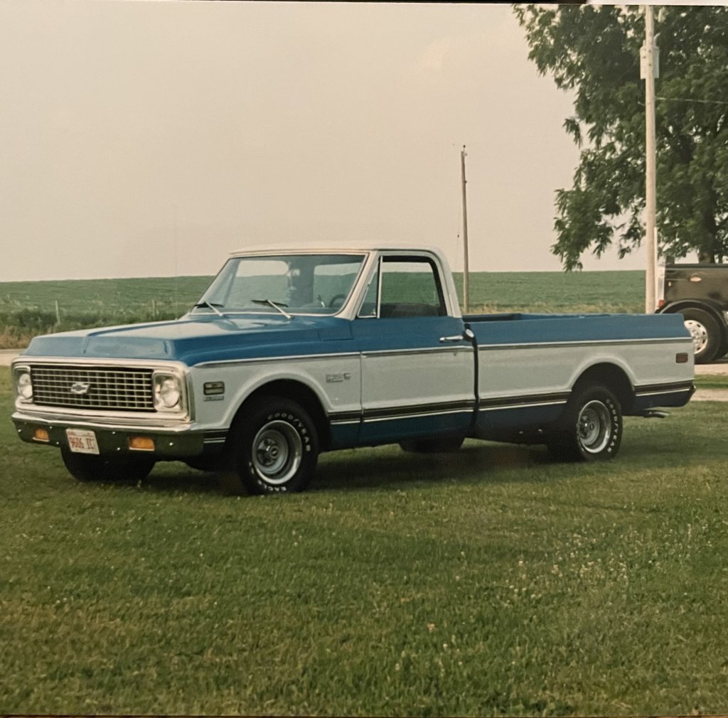

7” & 8” rims will handle the 275/60. My brother and I both ran that type of setup. The pic is of my brothers 71 Cheyenne with 275/60 on all four corners.
