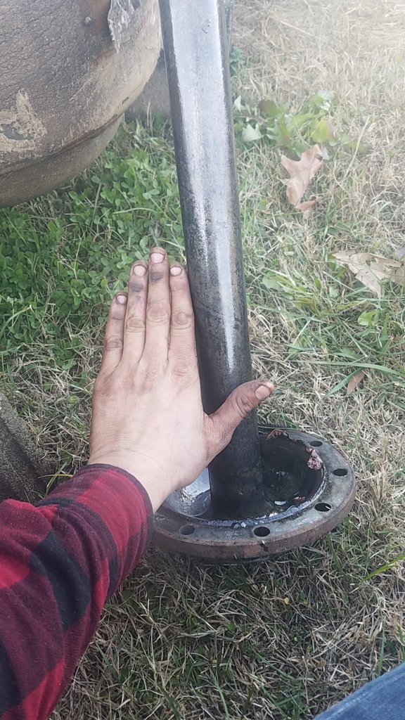

Wow, the one ton shafts make those regular shafts look spinly. I've seen shafts on this forum before that I couldn't figure out how they carried a tire "that big". (means the pic of the tires and axles)

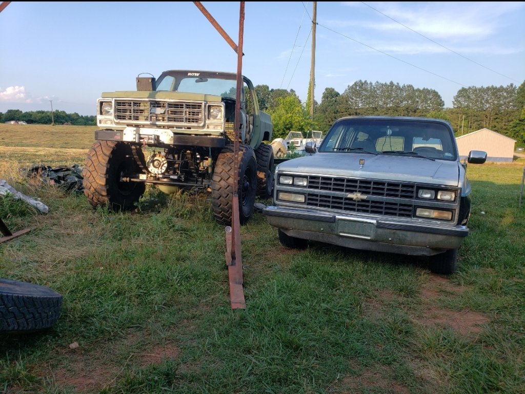

Well, it CAN be that simple. People used to do just that all the time, with the big lifts and 44" tires. However, their trucks were always broken, they didn't have a front driveline, and they had a hard time driving them down the road and keeping them between the ditches.
If you think that 1 ton is pretty beefy, you should see the size of a 5 ton shaft... its 2x bigger than that 1 ton lol

I can understand the cost of a fully built dana 60 for the front anyway. $$$$
What you could do- is get some chromoly axle shafts. They are stronger than the stock shafts. Better metal and usually don't have the necked-down weak points. But once that is stronger then where is the next weak link. Differential/gears/driveshafts...
On my '78 K15 I just had 33" tires and romped on it at a stoplight years ago. Snapped the rear axleshaft on the 12 bolt axle on it...

My truck is the "little" stock height 3/4 ton in the photos.
The green Sub is on an 8" lift and 37's.
The monster rolling through is on a 12 inch lift and was built for 44's, but in the photo it is rolling on 42's.
The black truck is on a 6 or 8 inch lift riding on 36's.
I like them all! But the huge multi color one is awesome! And the black one is setup perfect!

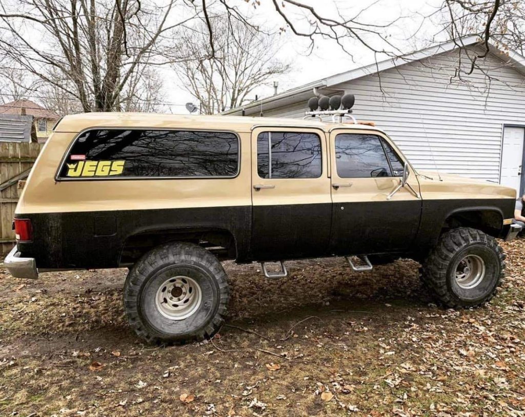

Thanks for the help. Can you help me out trying to guess the lift and tire size on this suburban? The guy who owned it told me it was a 12 in lift on 40s, but i don't think that's accurate.
he lied to you......there is no way in hell he has 12 in lift, id be surprised if wasnt a 4 inch at most..
