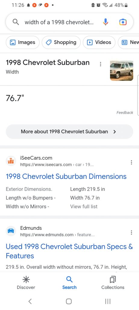

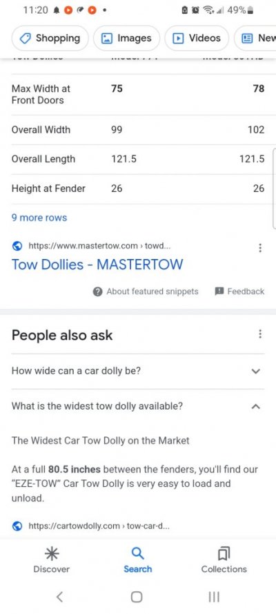

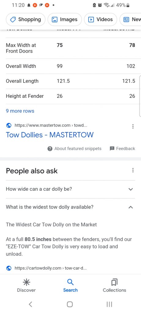

Looks it would be tight make sure the bottoms of the doors or rockers won't hit anyithing in turns.

So are thinking of trailering it or in a dolly? My byrb wouldn't fit on the dolly we were using I had to trailer mine. My 75 wouldn't fit the dolly or the trailer had to pull it on a tow bar. I noticed your comment about Kansas City. Are you close I've still got the tow bar for my 75k. Nevermind,that was stupid I have no way of knowing if my tow bar would work on your rig.
I've looked at several tow dollies on the internet widths from 75 inches thru 80.5 inches. You need to measure what ever dolly you plan on using. And I've seen damage done by too tight of fit in a turn ,so I make very wide turns.
