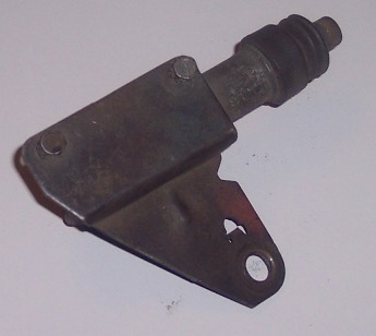

Since it's related, here's some pics I've posted on this forum before.
47,014
9,008
And just for giggles and *****, here's an older style that has been used on late 60's through mid 70's cars. This is a carb mounted switch, that is engaged when you open the carb linkage full throttle it would bump the switch. I sold this Original Delco Remy Swtich on eBay for $49. Rare and hard to find these days.
