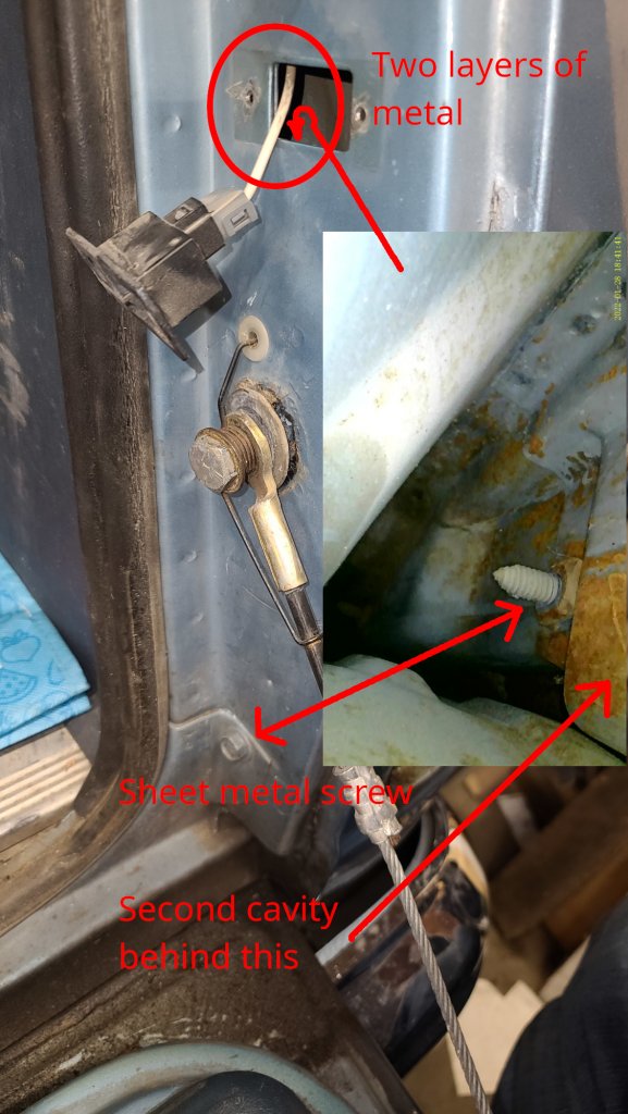

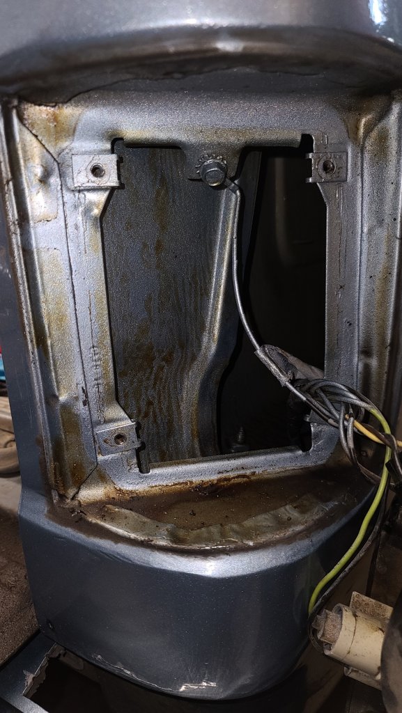

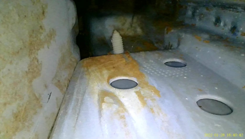

Yes, back when the nut first broke off in there. Going in and turning to the left, don't have a good picture of it, but there's metal all along, no crossing back over through there. There's at least 2 more layers of sheet metal between the two cavities. The closest I can get is by going in by the connector up above the tailgate strap bolt, but there's another sheet metal layer blocking me off there as well.
I suppose the most clever option is to drill the spot welds surrounding the strap bolt and attempting to re-weld them.
