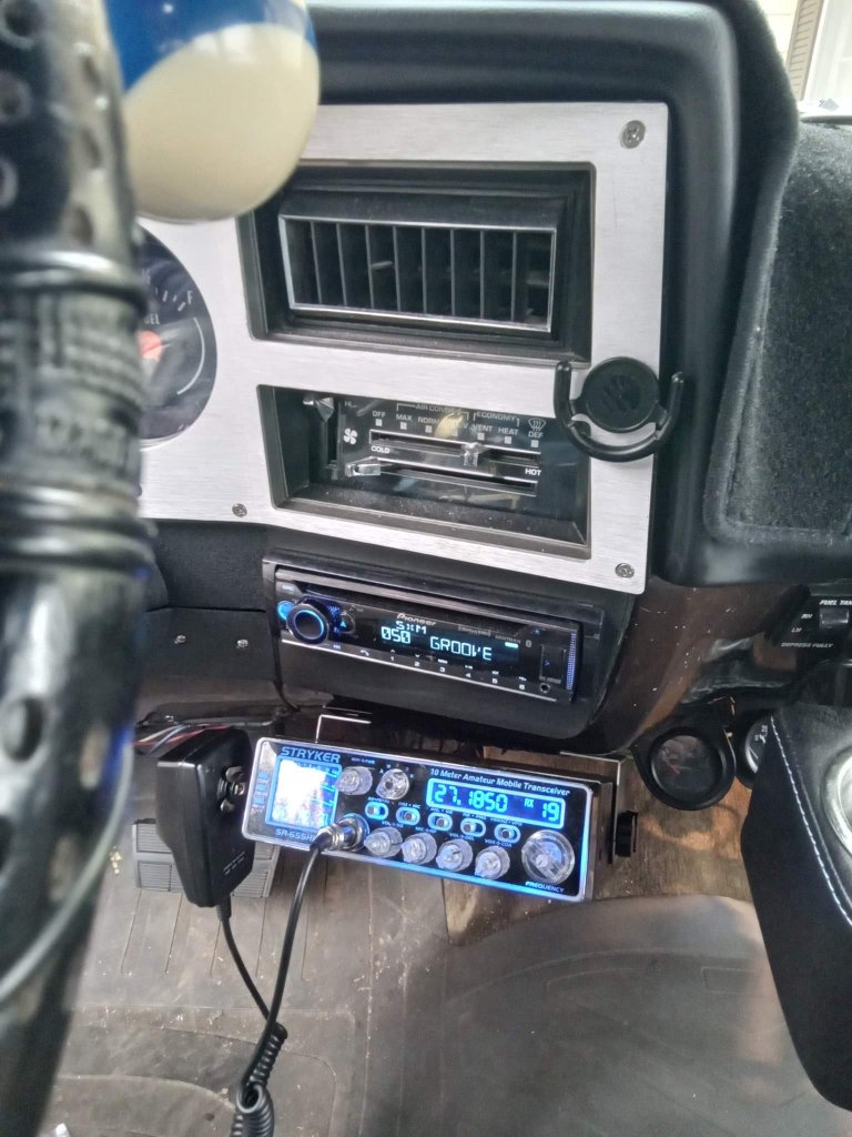

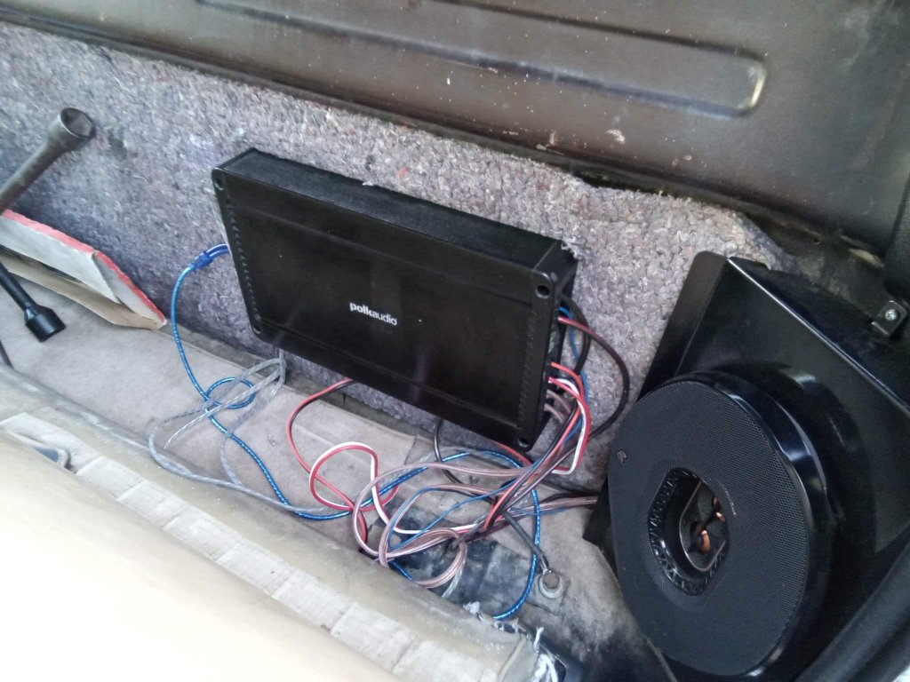

hey steve! i added an aux jack to my stock delco...run the music from my iphone 6....(last one with a headphpone jack) which is great cause i also use it to talk on the phone and it comes through the stereo! THEN.....i added an amp, sub and two 6x9's ......i can throw a toggle that turns on the amp....and jammin i go! took a few tries to get it right...but was worth the effort i will try to post some pictures later this week

OK....so I started this with an analog delco with an aux, 10" subwoofer, and 6x9's in the carpet covered wooden box. it sounded like crap. I was told the analog stereo was sending a "dirty" signal to the amp, from my music on the phone, the 6x9"s were jammed up against the seat which cut all the high frequency and muffled them, and the 10" sub was just TOO much for the small cab. The 6x9's are now in the corners and sound great....could not fit my pioneers with the big magnets, but theses $99 Kickers work just fine. The sheetmetal speaker holders rattled a bit, so i removed them and set them in polyurethane caulk to hold them in the cab. not pretty, but effective. The delco runs my door speakers (without the amp) on the front channel for news, talk radio and talking on the phone....80-90% of the day The red toggle is the trigger for the amp that runs the 6x9's and the sub off the rear channel of the delco......been like that for about 2 years....wouldn't change a thing. PS.....I tried one of those retrosound units in another vehicle.....its back in the box on the shelf

powered subs work great! have one in my elcamino in the smuggler compartment....doesn't take much with the small cab space...you can probably fit that upright behind the seat in the pickup......taking out that seat really sucks
