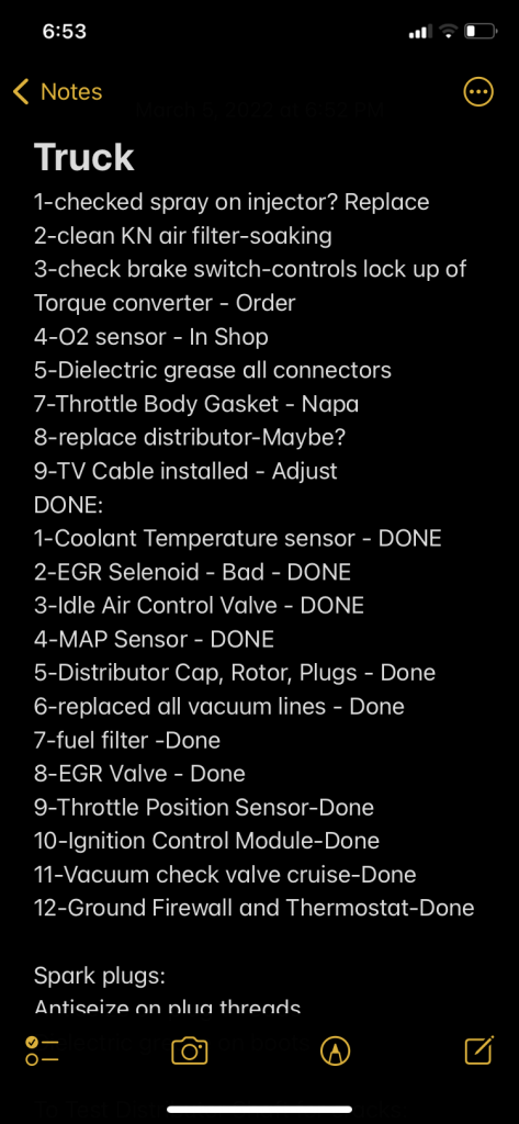

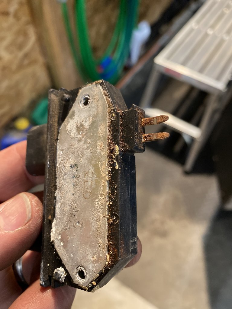

Replaced the Ignition Control Module, was all rusted up. Fired right up, idling OK gonna try taking her for a ride tomorrow.
