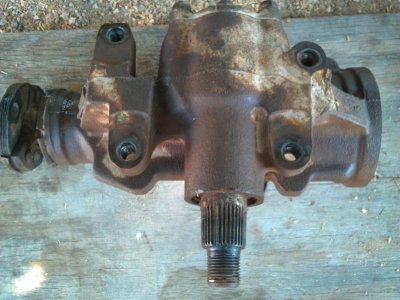

2WD box:

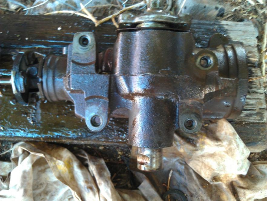

4WD box:

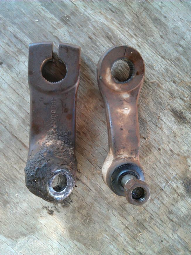

Left: 4WD pitman arm & right: 2WD pitman arm
Around 1980, Saginaw (made most the boxes for GM, Ford and Chrysler) changed the power steering line fittings from standard to metric.
The posts below are the interchanges, the numbers are the Hollander interchange numbers, not all junkyards use these numbers. You can click on the links below to skip to your year, model and type of box needed.

2WD box:
4WD box:
