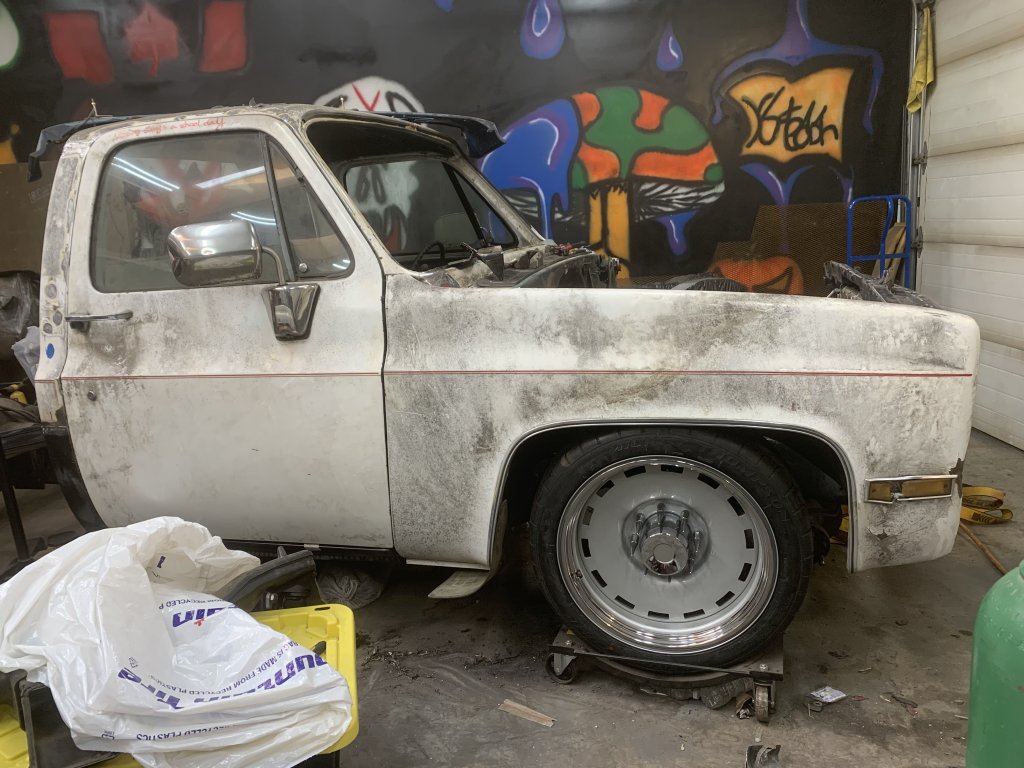

Neither had I, but for 110$USd difference in price I’ll be a Guinea pigI had never even heard of Street Edge, but I also haven't spent much time around lowered trucks in recent years.
Going on a c30 stock brakes and 20” DSW DelraysStreet Edge, Bell Tech, Western Chassis/ POL are all the old design which is fine for 15-17" wheels and stock brakes. If you plan on doing any brake upgrades or big wheels, spend a hundred or so more and buy CPP Modular or if really going big, CPP X10 or Wilwood. The CPP's also suck the wheel into a drum offset which helps with scrub radius, fitment, etc.
