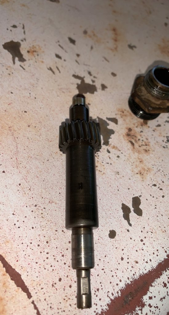

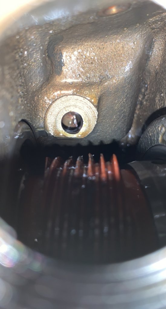

1978 Chevrolet k10 bonanza 350sbc sm465 and np205 tcase.
When I got the truck the speedometer didn’t work, take it all apart test everything individually it worked, reassemble it would work the first time the truck moved but once you stopped again it didn’t work. Now it doesn’t do anything at all. The gauge works, cable is good, and the “ratio adapter?” Off the tcase seems to work fine. How do I go about digging deeper into the transfer case to find out what isn’t working? Cable spins speedometer by hand when removed from tcase, the adapter piece spins both sides, but something isn’t driving that adapter piece. I’m not 100% sure it’s a 205, the shift pattern is 4l, N 2H, 4H and my research comes to a 205.
