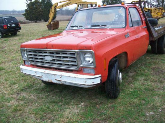

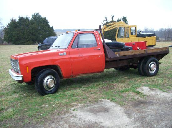

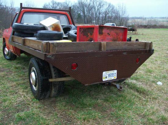

How come we haven't seen pics of this dually C30? Is it a Cab and Chassis C30 or a Pick up truck C30 with hips on the bed???

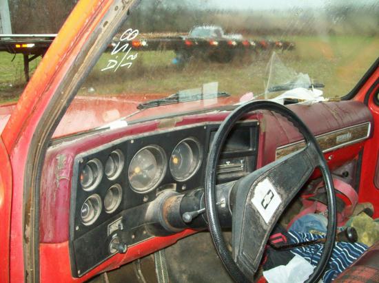

here is the photo's when i got it in march of this year.

OH yeah, I member now. That looks like it was pick up, not a C&C.

it had a wood stake bed when it was new but the owner told me in 1991 it was replaced because it had rotten to nothing the bed that is on it is from a 1970 ford f350.
47,014
9,009
So maybe it is a C&C then. The VIN # would tell you for sure.
29,087
23,882
It's a 14bolt rear, so that automatically means it's a cab&chassis model.
47,014
9,009
Ahhh yes, or it would have had a Dana 70 for a dual 1 ton.
