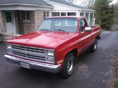

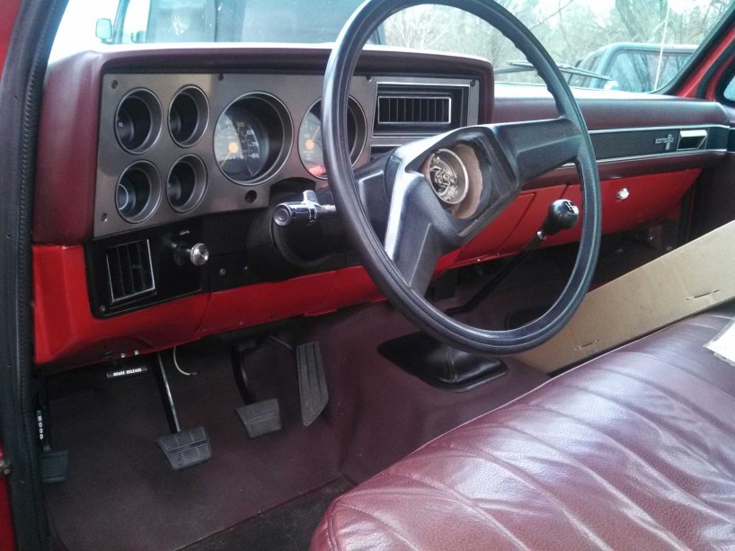

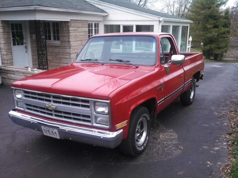

I have a 1987 R10 5.7 with a SM465. I really want to go to a 5 speed to get an overdrive. I really have no need for a granny low in this thing. It is bone stock and completely unmolested with 86,000 miles.
