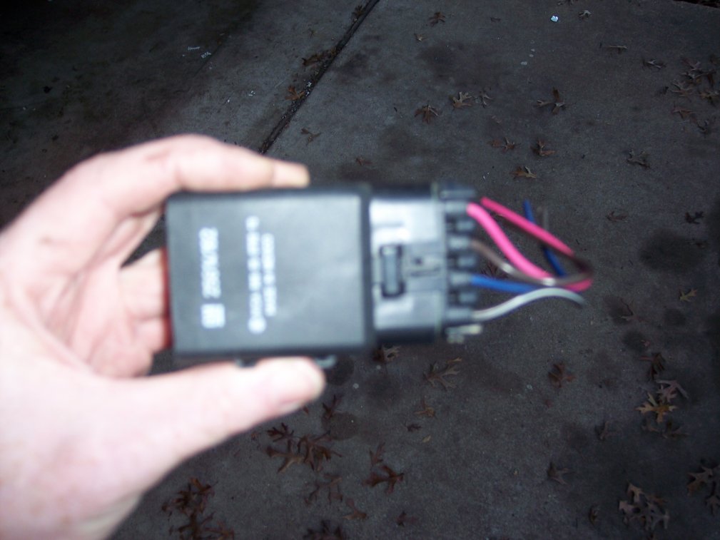

First of all, you will need the auto-down module from any 1993-98 GM C or H body which includes Buick LeSabre/Park Avenue; Olds 88/98 and Pontiac Bonneville. The module is located in the front door and has 4 wires coming out of it. Below is a picture.
Get a length of wire with it too, as much as you can.

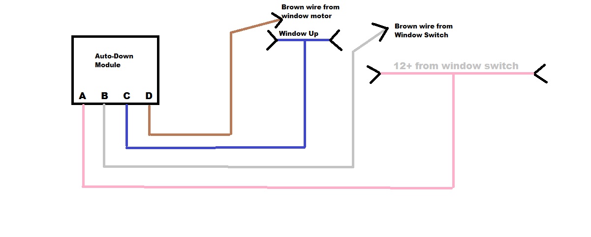

Now you can begin the install. Remove your door panel(s) and find the 12+ switched wire (pink) coming from the window switch. The wire colours coming from the module are different colours I have found so I will simply label them A, B, C, and D and those letter are marked on the connector.
Make sure to find a location for the module that will allow enough wire to reach the main window harness and stay out of the way of moving parts.
Wire colours from the main harness will be the same from side to side (I think).

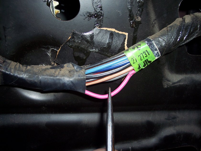

Wire A will be spliced in line with the pink wire. No cut, just splice.

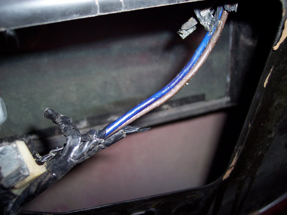

Next locate the DARK BLUE wire that goes from the window switch to the window motor and tap in to this wire using wire C from the module. No cut, just splice.
Now locate the brown wire that goes from the window switch to the window motor. You will CUT this wire. Wire B from the module will be spliced with the side coming FROM THE WINDOW SWITCH and Wire D will be spliced with the side coming FROM THE WINDOW MOTOR.
