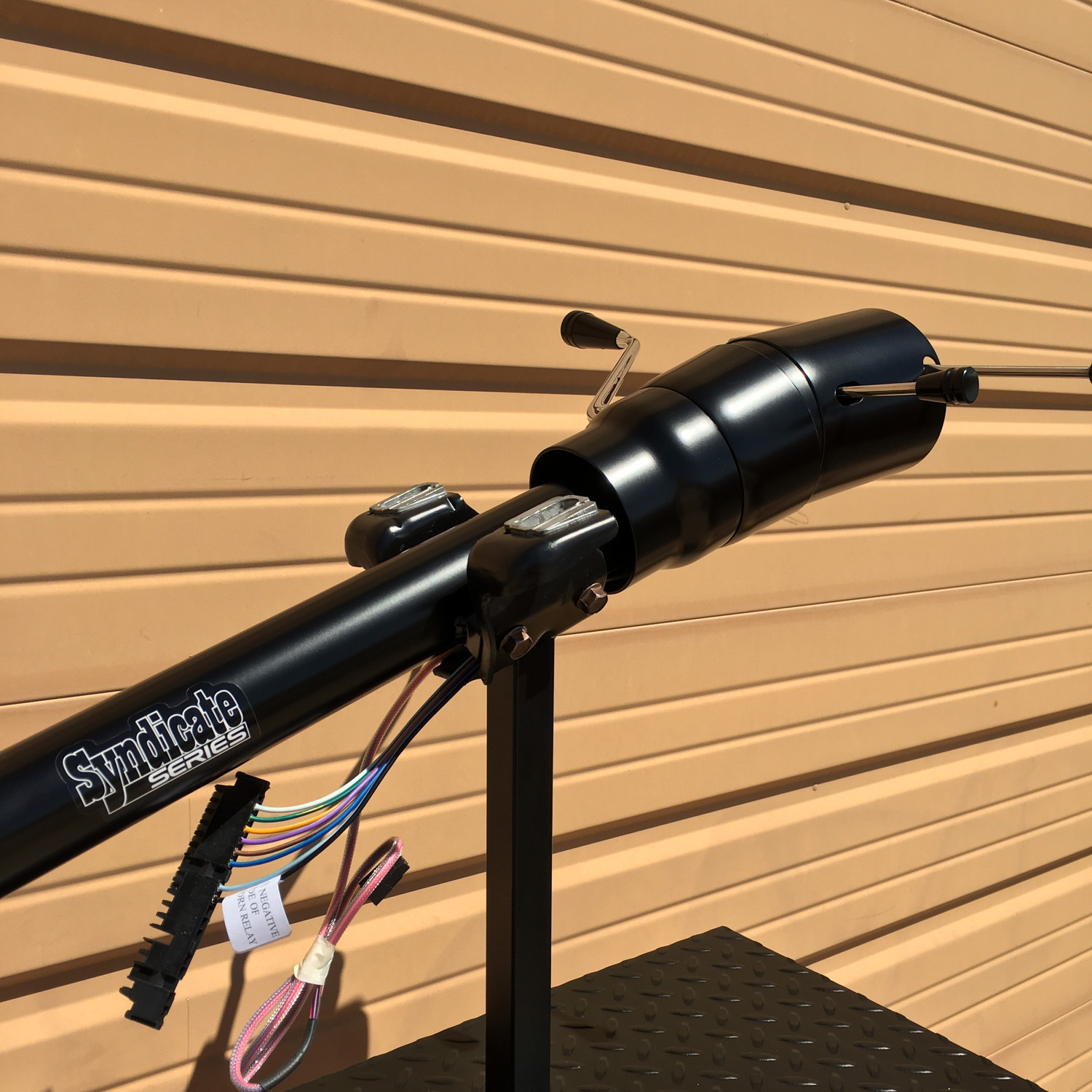

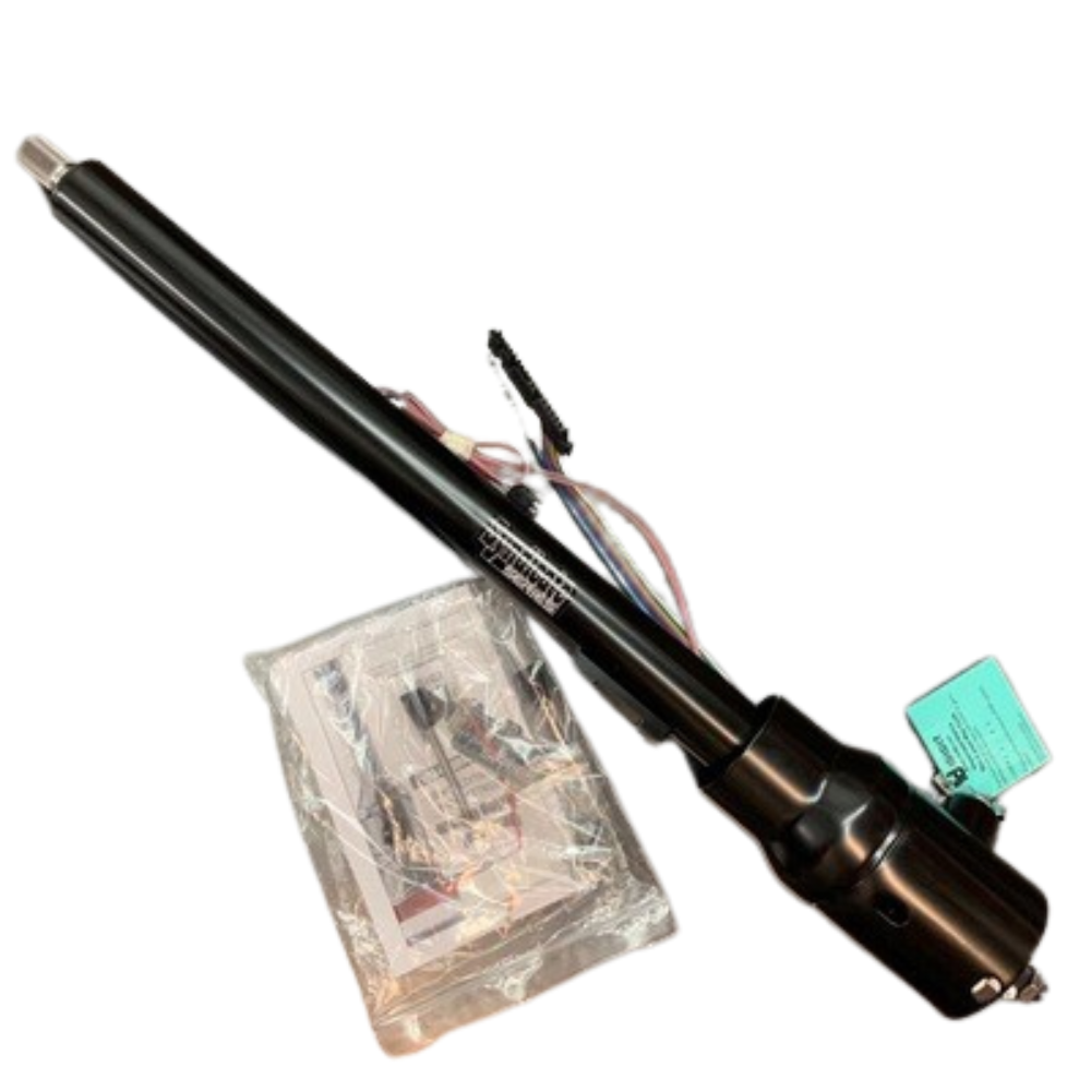

Not cheap, but I think they are 2 inches shorter.
