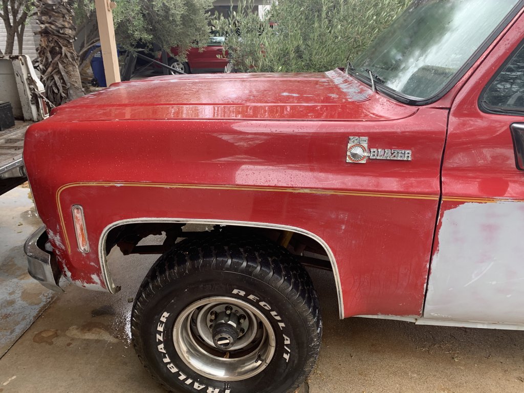

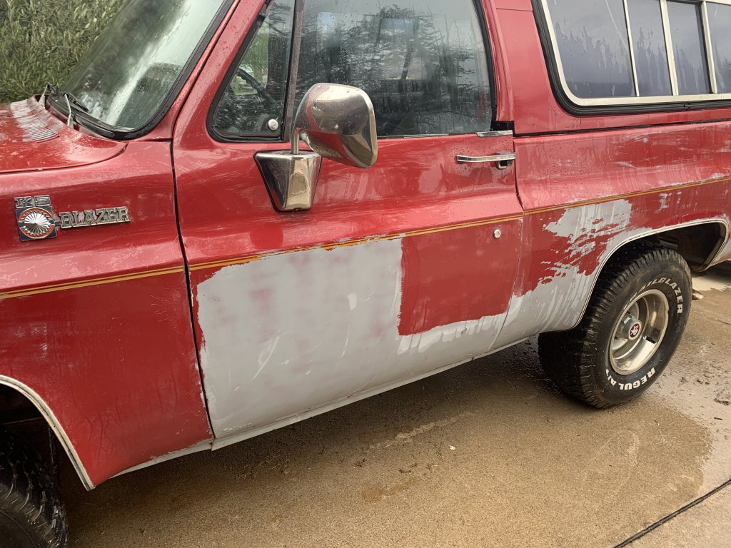

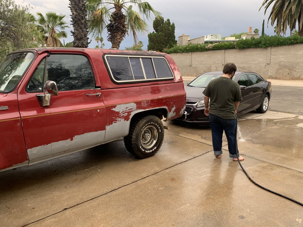

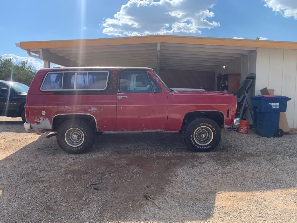

Ive been removing primer from my 74 K5 Blazer every weekend for 2 years. I use a product called Citristrip. Its not harsh and works very well on a top coat of paint that's just not quality or very thick. I put it on using a paint brush in an area I can pay attention to time was and let it sit for 5 min. I then use a drill with a round bristle attachment and hit that paint good...WEAR SAFETY GLASSES...cause paints gona fly. Then to stop the chem reaction I hit it with water from the hose. Here are some shots of the Blazer.
