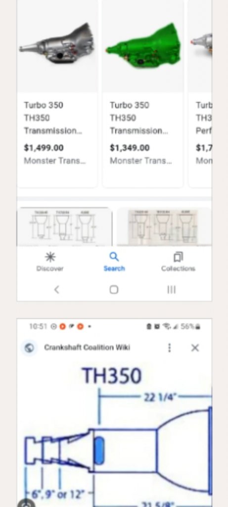

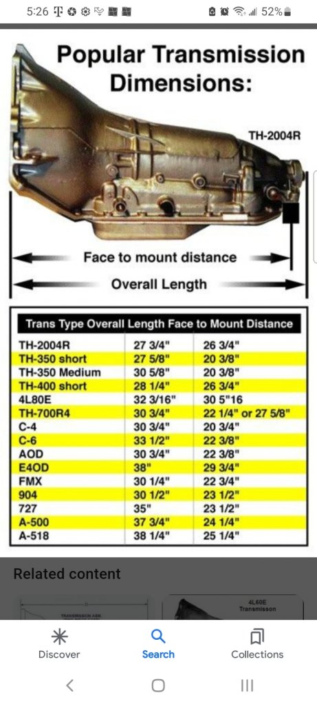

I have a TH350 (stock) tranny and the axle is the stock 10 bolt.
